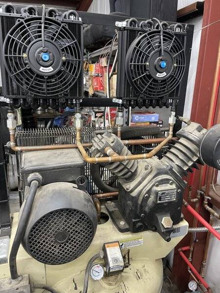

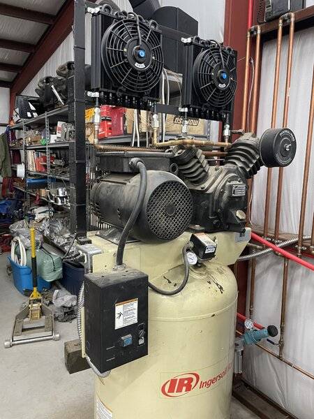

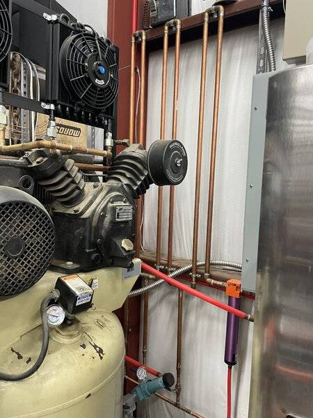

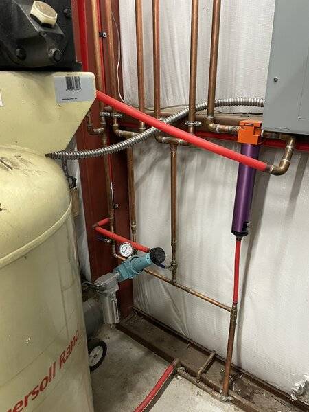

Yeah, I kinda pooched it there. Definitely need to get back to it and add more pipe above the valves, I just blow them out more often for the time being. But the temperature drop across the tubes is surprising.

This is an air dryer.

Post 55 is pictures of a homemade air drier installed between the pump and the tank.
If the hot air is dumped into the tank before the drier, then the air becomes ambient in the tank and the water falls out in the tank.

A loop like the one I and a few others posted with traps and automatic drains damn sure does keep water from getting in the airlines Sir.
