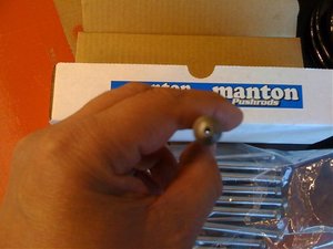

Anyone know who makes these rockers? They remind me of TD rockers. I posted a pic of the pushrod part# too. Anyone recognize that? They look like nice pushrods. They are ball/ball oil-through for a hyd roller setup and are 7.45 inch. Black oxide coated and no different than any comp pushrod I have seen...

So does anyone have an idea what brand those pushrods may be?
What does the MT prefix mean? I'd ask hughes but they'll probably just tell me they are "hughes pushrods" lmao.
I'm just curious who makes them. Hell I am curious who really makes the rockers too!
All of Hughes pushrod stuff is Smith Bros. That came from Dave himself...rockers I have no idea...

Are you running a Solid Roller in this one?? If you are you may want to look into thicker wall push rods dont know if .080 wall is gonna do the trick. I didn't run a roller but I still had Manton make some 3/8 rod, .095 wall with hardended 5/16 tips which are Real Nice pieces. You can also go thicker if you want to. They fit in the RHS Heads without touching a thing.
Nope, I'm running a hydraulic roller, but those are indeed the sexiest pushrods known to mankind. It's parts like that, that make you wish you had little windows in the motor to see them in action.

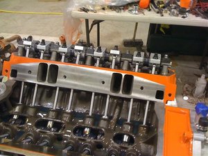

Alright so I got my RHS/Indy heads this afternoon and they're badass. I am very pleased.
They look like a solid head to make good power with. You just dont notice things in pictures. You have to see close up. The ports are really nice without being touched. Pretty smooth and NO casting flash whatsoever. I'm going to leave them as Brian sent them, and go with it. I have no reason to believe they won't do the job after what I've seen. Good work Brian.
The chambers are really nice....
Not that you need any closer, but screw it...
I promised to take some pics with the hughes shaft rockers on them...um, ok. Some nice big pics for ya....partially because people want detail, and patially because I'm not resizing them. lol
and another....
And another....
When I was first looking at the rockers at hughes, one of the things you couldnt see in the pics was how they mounted to the pedestal, what the fit was like etc and that bugged me.
So if the same thing bugs you and if you care, here. Mystery solved....
Now there is a problem...not that it's really a problem because no one screwed up, but rather something I didnt expect due to oversight. I can only gather the installed height changed the rocker geometry a bit. Correct me if I'm wrong. I'm just taking a shot in the dark here.
Why I say this is because I am definitely not getting an optimal roller contact on the valve tip. It's over more on the intake side. I dabbed some grease on the stem tip real quick to show what I mean....you can see the line.
Now "it'll work" since the rocker will move toward the center as soon as theres some lift, but I would think I should be closer to the center and that if I am not I'll wear out the guides. I guess the cure for this is to raise the rockers with a shim. I think from playing around, I figured about maybe 2.5-3 millimeters additional height can cure this. If I raise them that much higher I get a contact that is correct at just shy of center, and moving out acrossthe same amount during the sweep. I just wanted to throw that out as news you can use, and also to hear what people think of it?
I have some comp guideplates I can modify to chop off the guides that I think are in that thickness ballpark and would work pretty well for that purpose if need be. But I'm open to ideas. I want those pedestals to sit flush and solid just as they normally do. Opinions on that?
Brian, do you have experience in this situation in a mag head? Or am I the first oddball to want them instead of the LA with these rockers on them? lol
I know the LA heads frequently need the shafts shimmed up too, but I was blindsided by this. Didnt even think about it.
Is it really as much of a big deal as I am making it?
and another....
And another....

Nope no shims were included. You're looking at a pic of the pedestals they come with, and in the pic to the valve tip where the rocker rests with the valve closed.
I'll get a sweep pattern with some marker soon as I get home from work today. What I was trying to show is where the roller rests as a starting point which is on the intake manny side of the valve tip and a little close to the edge. My sharpie markers are always gone...I have an 11 year old.
I'll take care of it later. And no sweat, like I said everything's awesome. I don't think the hughes version of these heads will support the lift yours do. That's the difference. I believe the rockers as designed are mainly intended to go onto a stock head, or one with minimal preparation and not as much of a valve or spring is the deal. But this can be straightened out with a slight height adjustment of the rocker.

Also in looking at theirs, it's way too much. looks like at least 5-6mm on their shim, maybe more. I only need 2.5-3mm more height. Their pedestal bases are keyed to fit into the register of that rail as a means to stop any side to side movement.
These are connected with the shaft so there's no need to key anything as the shaft doesnt allow any side to side movement. Keyed meaning the flats milled in the pedestals of the examples you've shown to fit into the rail.
All mine would need is a flat piece of steel to sit on like how a typical comp stud would sit atop a guideplate. Plus I have a lot more faith in them sitting on steel rather than aluminum.;)

Brian, here's a picture of the roller resting on the valve tip (closed position)...just in case what I was saying didnt convey the idea. hehe
Too far toward the intake side, correct?
I'll get the sweep pattern later. I have a meeting this morning and I'll do some more tinkering soon as I have time.
