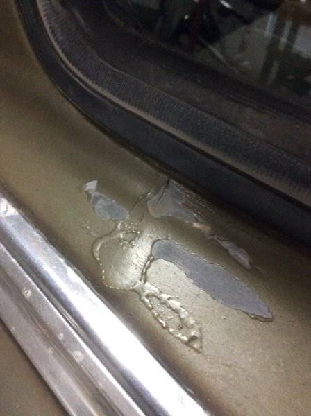

Both my quarter panels are cracked on my ‘66. One was cracked on my ‘64 in the exact same place.
Yes, these cars were produced for the masses and not expected to last 10 years.
