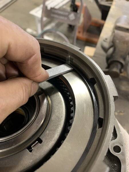

Checked clearances and the forward drum is .040”, direct drum is .039”. I blew some air through the ports on the pump, and the one that pushes only the forward drum was fine, but the port that goes to the direct drum pushed both drums up.

Where are you measuring that direct drum clearance? .039 doesn't sound right. Did you check the direct drum with the forward drum removed?
I measured at the upward sweep of the wave ring on the direct drum. I’m getting confused - I don’t know how I can check the clearance on the direct drum without removing the forward drum.
Oh I meant air check the direct drum with the forward drum removed. But are you saying that you only have .039 from the top of the pressure plate to the bottom of the inside of the top of the arc of the ring??? Could you post a pic of how you're measuring that?
Yes, I was measuring from the top of the pressure plate to the bottom of the inside arc. I'll be at the shop in a couple hours and I'll post some pictures.
But you know what, here's why I shouldn't work while sleep deprived. For some reason I was thinking the clearance specs on both drums was the same, and I think I ended up putting an extra steel in there. I betcha that's what happened and why the clearance is so tight, because now that I'm rested and looking back on my literature, I see the direct drum clearance is three times what the forward drum is.

Checked again without the steel that wasn’t supposed to be there, got .092.

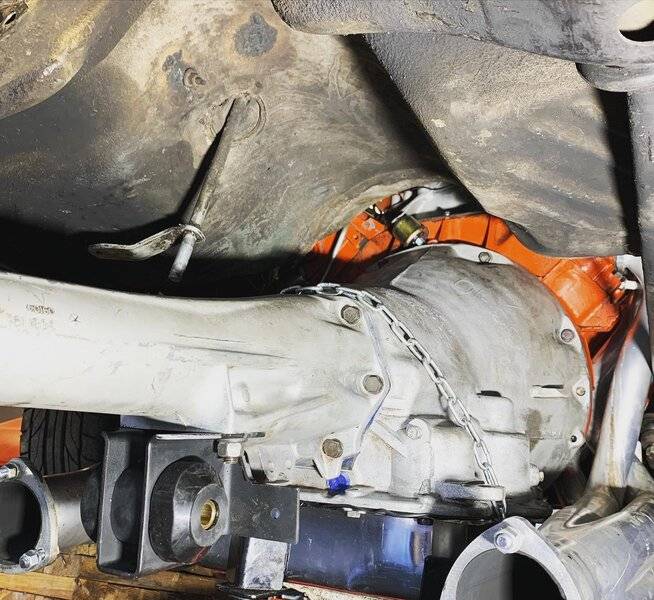

Well, I got the car started and took it around the block, and it does shift, but I think I need to adjust the kick down. I was very pressed for time and needed to get it loaded and out of the shop, so I will need to get back to it tomorrow. I really, really hope I didn't screw something up.

Well, I think this thread can be put to bed! As always, with immense help from FABO, books, videos, and about 60 gallons of Miller Lite, the 727 is finally back in the car and operating smoothly. It takes a while for me to get things done, because I work slowly when doing something I'm not proficient at, and my schedule doesn't allow me to be in the shop every day.
When I loaded it to trailer it home, the transmission was slipping pretty badly. I had added 5 quarts and have a filter extension with a deep pan. I thought that would be enough to get her going, but I was wrong. I saw a comment that @RustyRatRod made about deep pans and how it doesn't matter if it's ten feet deep, fill it to the full line. I ended up adding a total of 9 quarts!! Shifts beautifully now.
One thing I'm confused about is the effectiveness of the TransGo shift kit. I don't notice a difference, or at least there's not a night and day difference. There was a bigger difference in the Scamp's 904 when they took out the wave snap ring, but who knows.
Are you saying it was slipping badly AFTER you rebuilt it?!? It's easy to fry the forward clutch....4 quarts low would sure do it; if it pulled at all...
