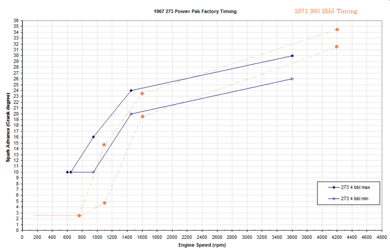

One thing I didn't want to get into before, before you had the basics worked out, is the advance curve itself.
But now it may be a good time.
IF your initial measured 26* when then engine was idling at 1200 rpm and
then
you measured 10*, but the engine was idling at 800 rpm
this would show that the timing was advancing rapidly between 800 and 1200 rpm.
That would be very normal on Chrysler distributor.
I can't over emphasize how important it is to know the rpm that timing is measured.
Here are two example plots illustrating advance on small block engines. Notice qyuickly advance changes the timing above 800 rpm on the 1971 distributor.
