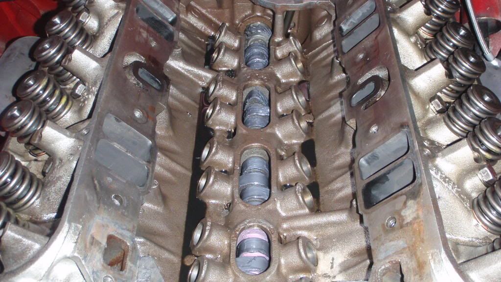

Decided to swap cams in my 360 Valiant to try something a little more street friendly than the cam I have now from the PO.
It was an Erson solid cam with these specs and recommendations
Hot Street/E.T. Brackets. Great mid-range performance from 318-340 CID engines with 10.5-11.5:1 compression. Needs modified stock or W-2 style cylinder heads, gasket-matched, single plane, open plenum intake manifold and up to 750 cfm 4-barrel carburetion, 3,200-3,600 lb. Bracketeers can use 4-speed manual or torque flyte automatic with 3,500 RPM converter and low gears.
3,500-6,500 rpm range IN 242° EX 246° IN .510" EX .510" 108°
I tried to get things to work better with this cam that the previous owner had placed in the car by changing some things like adding headers, timing changes, carb, intake, etc. but ultimately I don't want a bracket car. This is what this cam was built for. I need something I can enjoy more on the streets and highway.
I went ahead and ordered the 60403 Lunati Voodoo 268 cam. I have heard good things about this cam and hope it makes my car much more drivable and enjoyable to me at least. I think it better matches the parts that were already on the car and the parts that I have recently changed.

Had to wait for new pushrods to show up and it rained last weekend. Finally got everything buttoned up today. Rotella 15w40 and cam break-in oil additive is in. Lots of moly lube on cam and plenty of assembly lube on other parts.
Carb float bowls are set. Just need some water wetter and some distilled water for the radiator. Then I'm ready to prime the engine again, stab the dizzy and fire her up for 20 minutes. Hoping everything goes well. This is my very first cam swap. I'm keeping my fingers crossed.
Did you centerline your cam with a degree wheel & TDC stop? Lining up the dots on the sprockets is not very accurate. One tooth off can mean about 15 degrees.
