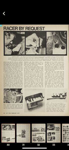

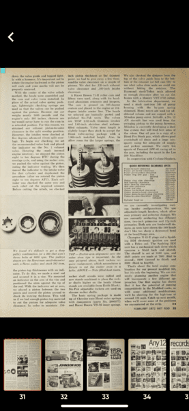

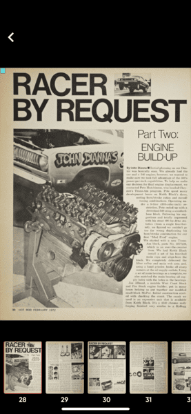

This at least shows how Carillo did it..
I just noticed that this part of the article mentions "Chrysler forgings" and "Rod bolts are NASCAR Hemi units" (7/16"). That would suggest they were the Mopar small block "Hemi footprint" rods which were beefed up like a Hemi rod but configured for a small block. VERY heavy, but then Carillo strategically machined them down to save weight without compromising strength.
The blocks not only raised the rocker shafts but moved them back for valve spring clearance and proper geometry. Also done later on W-2 heads.

Find the old Mopar Action article that was written about the race trans am cars with help of Bob Tarozzi who was team manager. There were a few article in magazines back in the day too. Here's one that was in Hot Rod: https://www.hotrod.com/features/blacks-mini-mopar-magic-april-1971-982-818-42-1/ it mentioned in this thread earlier.

That old mopar action article is good. There's a few article from 69-71 magazines. The 318 Indy motor was sort of a precursor/learning experience. Bobby Sykes at Keith Black worked on this stuff and his son posted here a few times. So you can search that.

Keith black racing engines did a lot of the 305 development work, for trans am mostly. The cam specs changed constantly. Those engines made about 490 HP and 355 ft. Ibs of torque, there are articles about them on the web.
