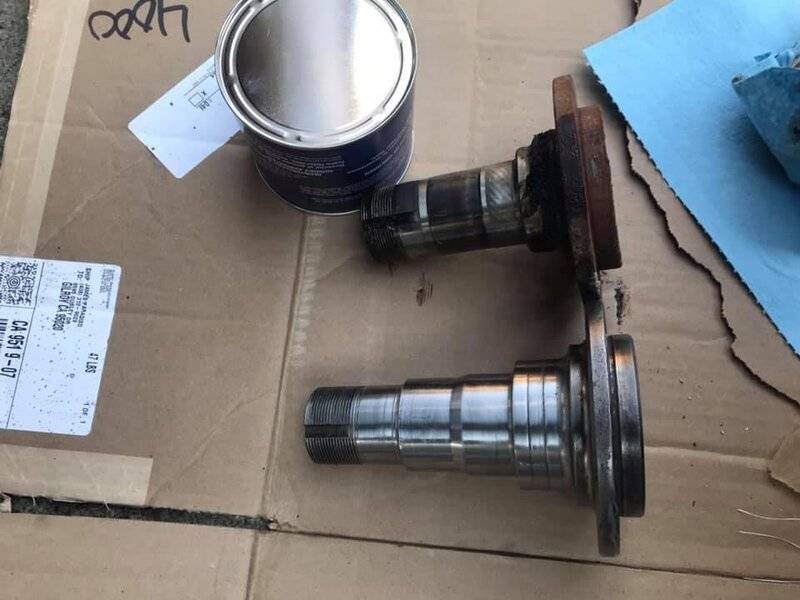

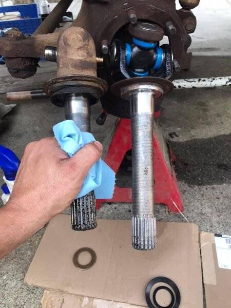

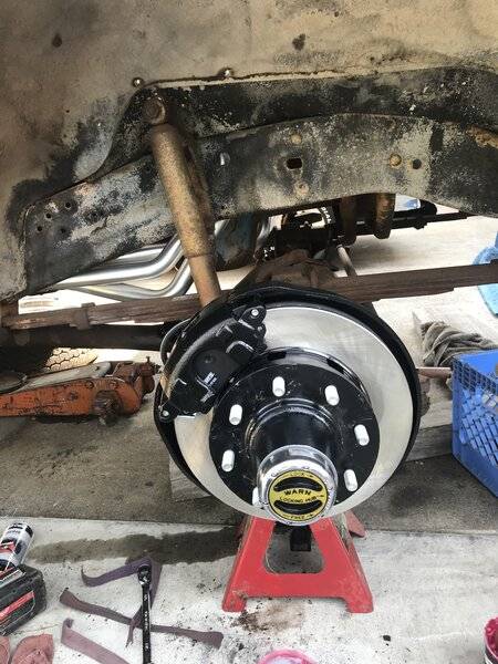

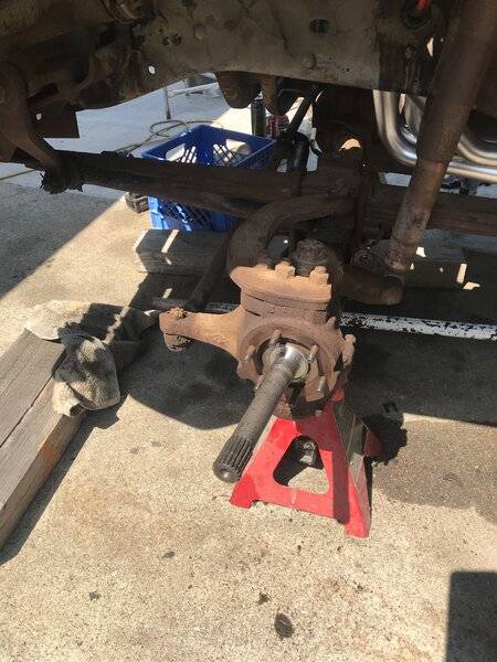

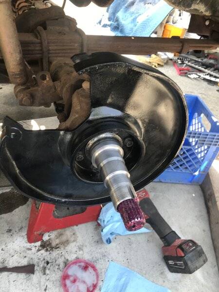

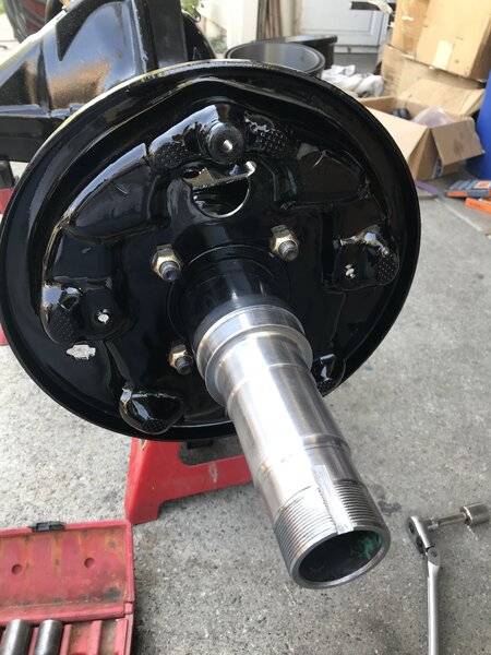

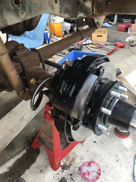

I did a disc brake conversion on the Drum brake Dana 44. I used Chevy parts off a 10 bolt front end. it’s all about the same stuff

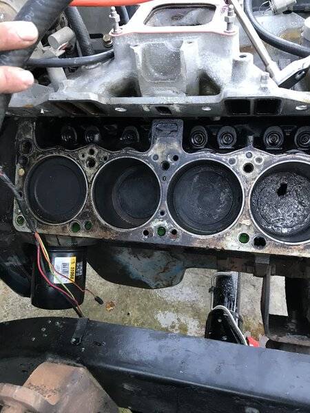

also hurt that 360 couple weeks ago like I said in the crank breakers thread..dropped a valve. Lead foot Lenny. LOL

Do you have a parts list for your disc brake conversion?

dropped a valve? that's kinda unusual. extreme over-revving?
That’s exactly what happened.... Extreme over-revving. Sure sounded good open header. LOL...Man I’m sure a thrasher behind a manual trans. Can’t keep my foot out of it. I have a rebuilt 360 with SpeedMaster heads ready to go in.

You will need to find a Chevy Dana 44 or 10 bolt. They are the same. I think ‘73-‘87 are the years. Must be a 3/4 ton 8 lug truck. I found a complete axle for 80 bucks. K-that is unusually cheap. The rotors and pads I got at Summit, 110 to my door for those. I spent 250 at RockAuto for inner/outer wheel bearings, wheel seals, axle u-joints, and upper/lower ball joints. I had to buy 16 new wheel studs because the ones that came off the donor axle were too rusty. $50 at Orielly Auto Parts. The calipers were reman units I got at CarQuest, those were $50. I also had to buy new warn hubs, the ones off my donor axle were missing. I opted for Warn Premiums, at Summit those are $127. Roughly $670 total all parts including the donor axle.
You probably don’t have to go to the extreme like I did, most likely your wheel studs would be okay, the old rotors could be turned, mine were shot. You don’t need warn premiums, you could save $50 by going with the mile markers. So there is a couple hundred savings right there.
from the Chevy axle you will need everything from the stub shafts out. Use the existing dodge knuckles, the Chevy knuckles have a bigger hole for the tie rod ends which doesn’t work with the dodge’s steering link.

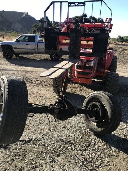

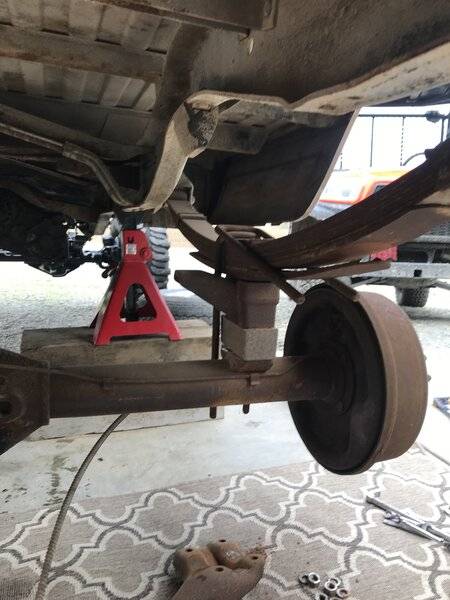

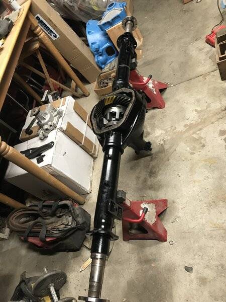

I found me a Dana 70 rear out of a ‘92 Diesel D250 I’m gonna swap in place of the rear 60. I’ll rebuild it and update with pics

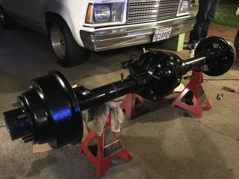

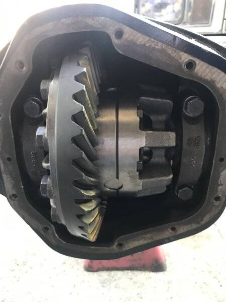

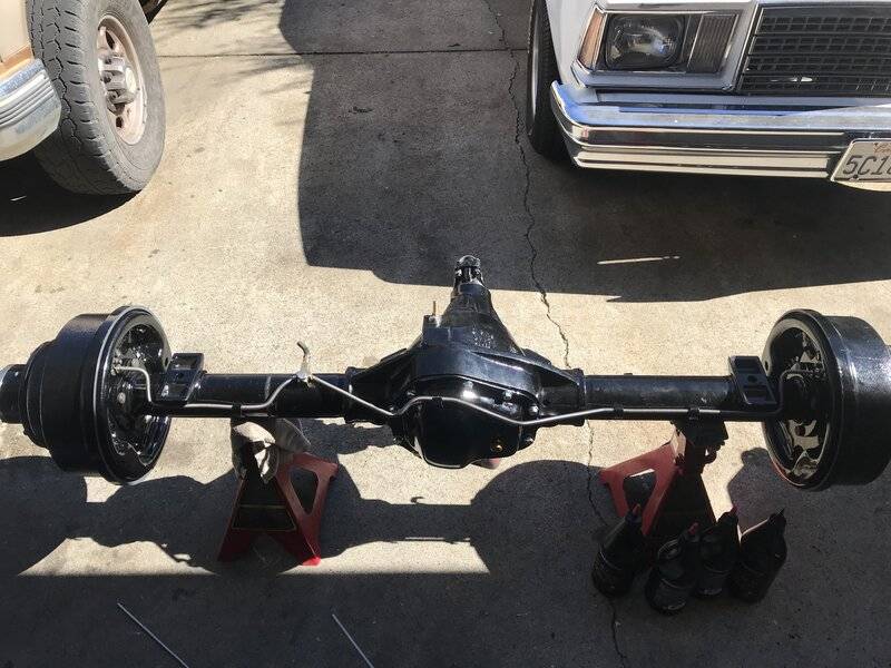

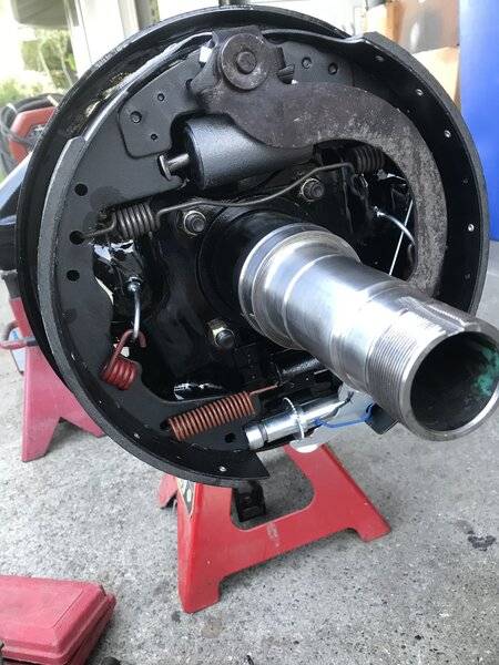

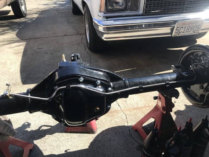

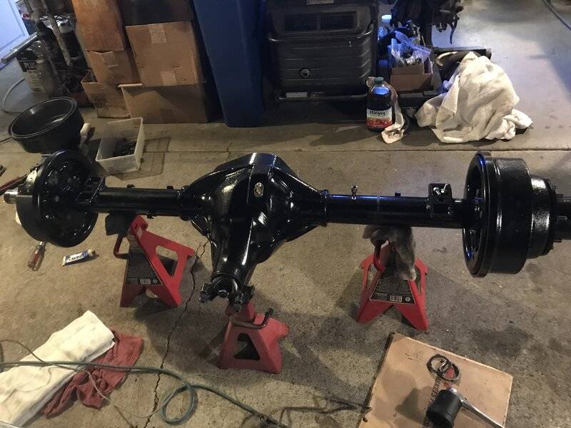

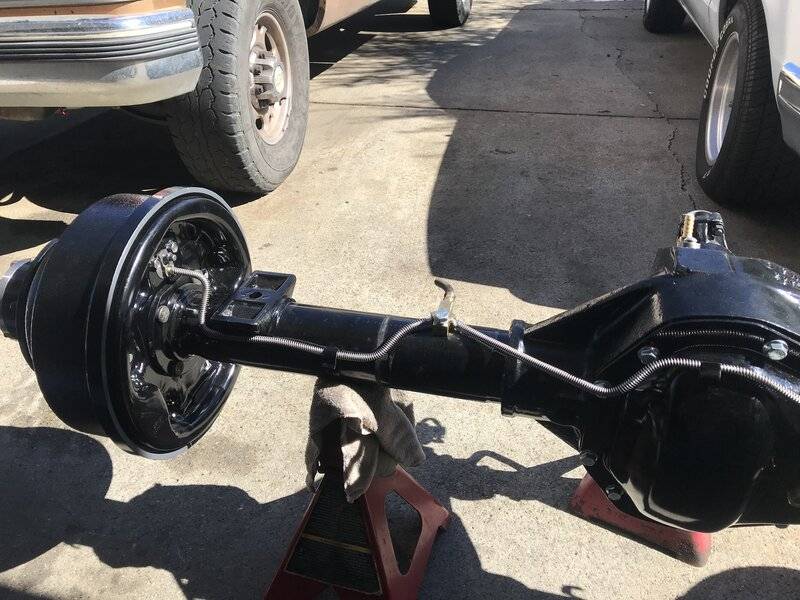

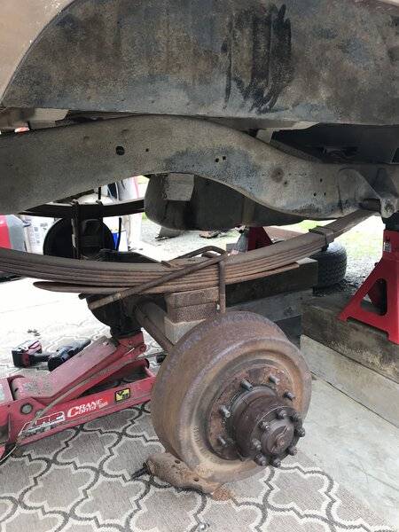

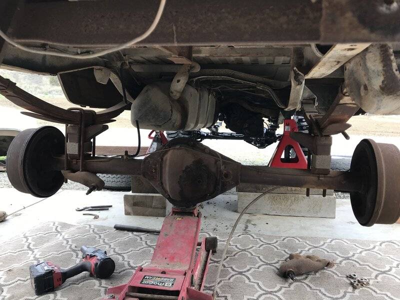

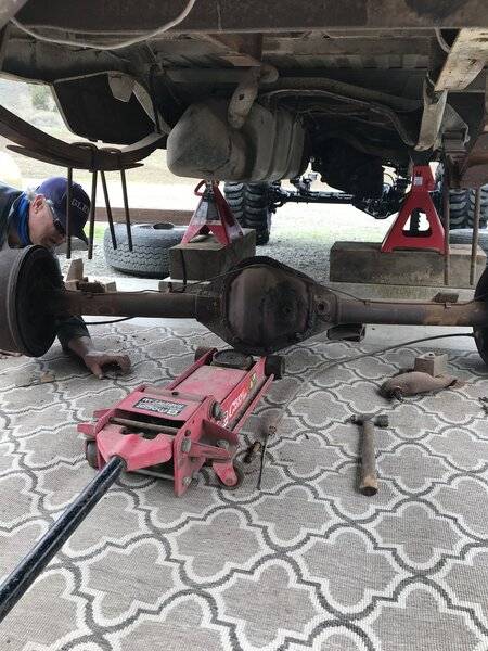

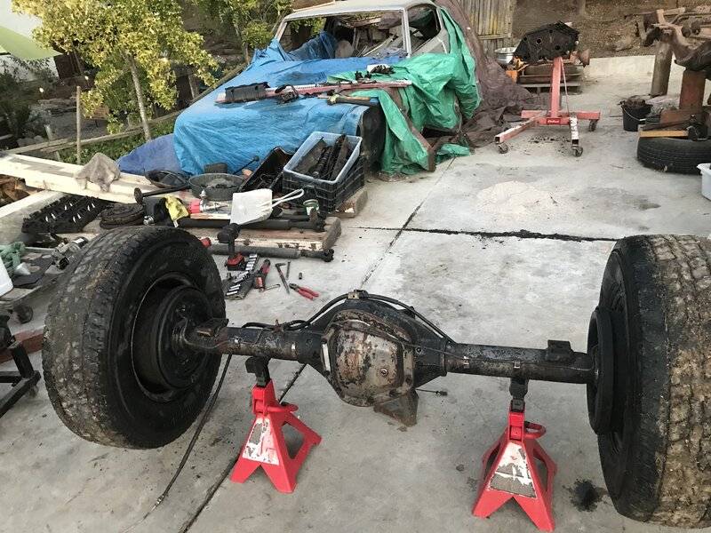

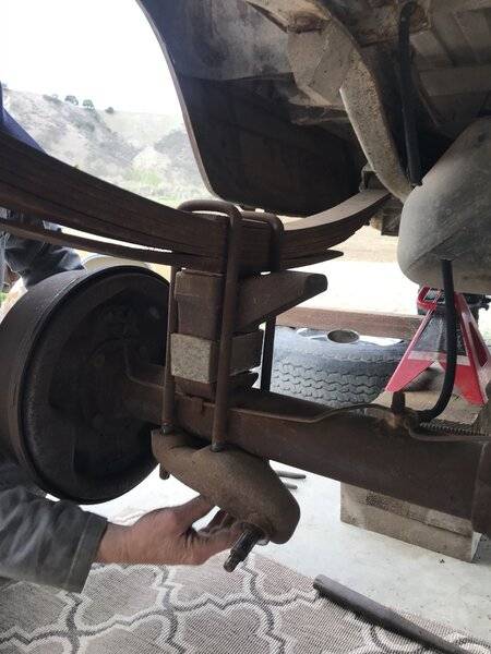

Well I got the rear end all done. It had 3.54 gears cuz it came out of a diesel.
So I went with a new set of 4.10’s and decided on a Detroit Locker, and upgraded to chromoly 35 spline axle shafts and 1410 pinion yoke. New brakes and drums, and made the brake lines outa stainless. That oughta hold up to my 4 speed thrashing I tend to do. Man it’s a heavy sonofagun.
View attachment 1715691317 View attachment 1715691319 View attachment 1715691322 View attachment 1715691325 View attachment 1715691328 View attachment 1715691329 View attachment 1715691330 View attachment 1715691331 View attachment 1715691332 View attachment 1715691333
Give me a couple of days, I think I have a line on something...
