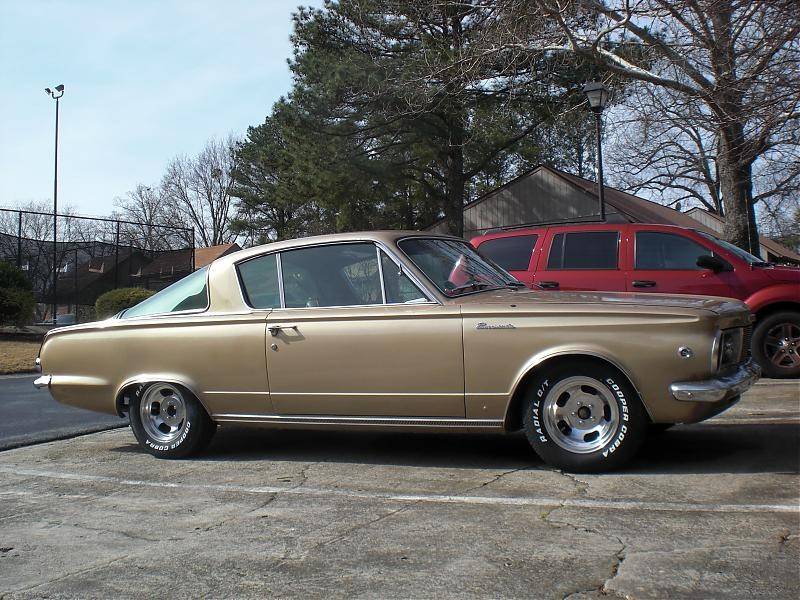

Here's a pic of Goldie I took yesterday. He's a proud fellow.

End of a chapter in life....and starting a new one.I guess I can't call you Gold anymore,best wishes.Welcome,Scorpion.Great first car,for a loved one.
WOW!
The wheels make a HUGE difference...NICE!!!
