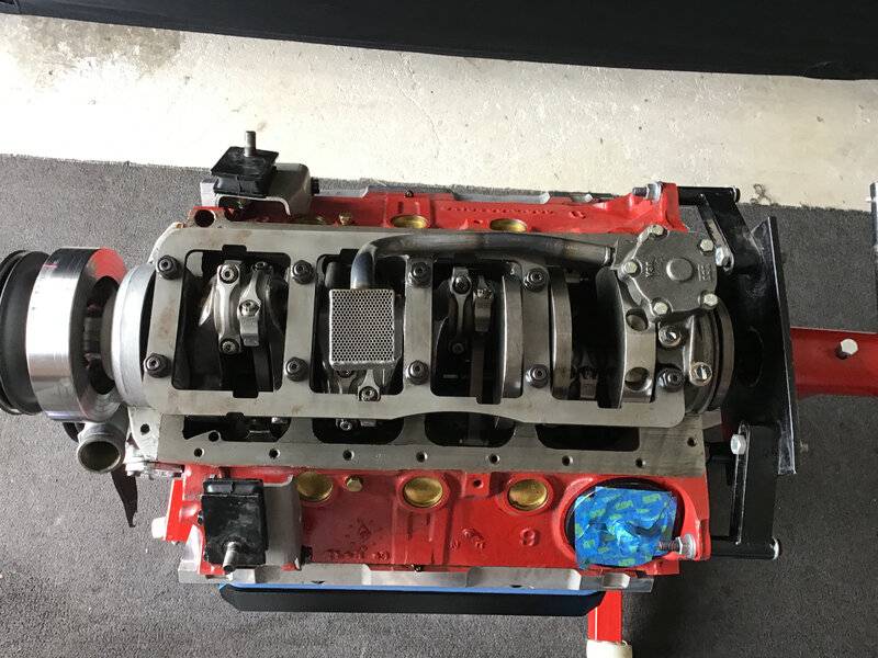

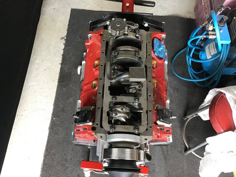

No clearance issues at all the only problem was the Hughes girdle with the Rods which was touching in some areas and we made the desired adjustments cleared the notches to relief those areas. Funny thing was Hughes diagram had some instruction stating the girdle had plenty clearance with I beam rods and with the H beam those areas will need attention. Note * check everything and don’t take it for granted .
