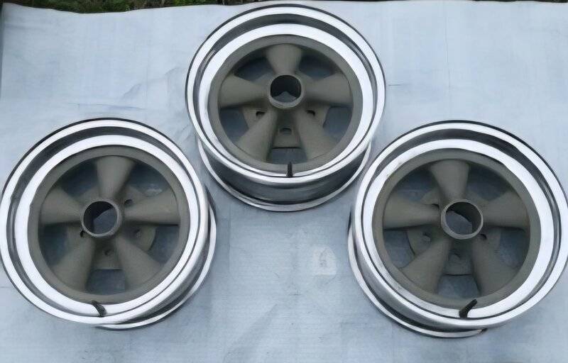

And the reason, I want to run the old school sbp Cragar Sparklers I have on the front.
They are 14x6 with a 4.125 bs and hit the UCA when turning.
My regular 14x6 Cragars with a 3.75 bs fit fine, and I have another set of hubs/rotors I can use for this.

I'm not a fan of spacers but they're not making the Sparklers anymore, barely made them when they were.
