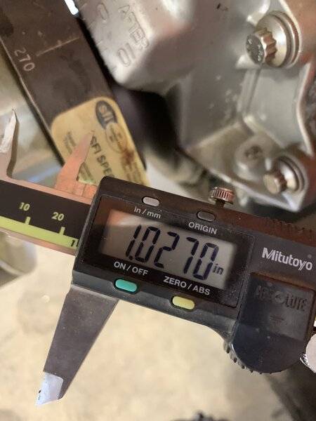

How are they on there thickness? I will need to get a new balancer for a couple of race mills in the works and the pulley alignment can be a PIA when the damper is thicker.

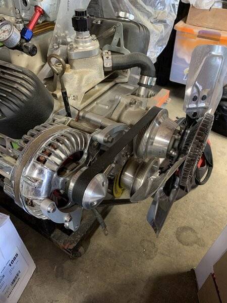

I have a 5” aluminum crank pulley and had to make a spacer to align it with the wp pulley. I can measure to the belt off the balancer if you need it.

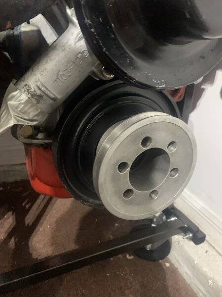

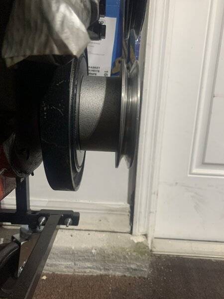

Thanks! But no… it’s not the belt size, just the damper thickness I’m looking for. I have (IIRC) the amoroso small diameter crank pulley as well. Here’s a picture…
I want to keep the stock thickness of the damper if I can since everything lines up now. I just don’t know what damper will or will not copy the stock thickness.
The measurement from the face of the damper to the belt would tell you if your current pulley arrangement would work with the Innovators West damper.

Hard to see things in your second picture.
I’m not understanding what I see in the first besides a thick & thin damper.

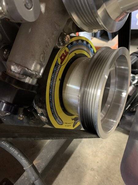

I used March 6 rib pulleys. No belt alignment issues. The dampener is just about an inch thick.
