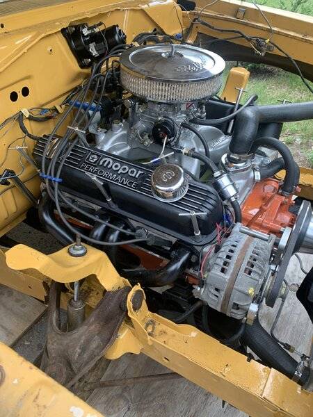

The OP looks like he’s leaning towards the XE268.
Seems like a solid choice for the combo to me.
Both Richard Holdner and Steve Dulcich praise this particular camshaft, and I trust their opinions. Now I'm undecided as to my LSA, if I should just go with the 110 or if I should have one ground at 107. My build is just supposed to be a hot rod/street machine, not a full racecar.
Unfortunately these are things only you can answer, everyone's levels of compromise are different. Will you be happy with a xe268h more than likely would you like a similar cam on a 105-108 lsa possibly.
Definately a good street cam. Comp Cams description and specs:
XE268H - 10
For 273 to 360 LA engines. That is a fairly wide CID spread. In a 273 it should be fairly lumpy while in a 360 it should be fairly smooth. That sentence is my comment.
At 0.050 tappet lift; I 224°, E 230°.
Adv'd ; I 268, E 280°
LSA ; 110°
Valve lift ; I 0.477, E 0.480
Largest recommended for a stock converter. In 273-318 it is best with a 2,000 stall.
This is Comp Cams information.
Again I recommend looking up and watching David Vizard's Powertec 10 videos on camshaft selection. One directly discusses the 128 formula.
Another good source of information is High-Performance Cams and Valvetrains by Billy Godbold, ex head cam designer for Comp Cams.
Both gentlemen are highly knowledgable in engines and camshafts. Billy comes at the selection process from an engineering perspective of getting relevant information regarding the engine and intended use. From there he picks the EVO then the IVC and finally the IVO and EVC points. David comes at it from the other direction and simplifies the decision making process for those of us less technically "in the know".
I do not dispute that the XE268H is a good cam. At Summit you can find it listed as XE268H-12 also. This is protecting them from the more is better think. A 112° LSA may allow an engine to pass an emissions test that a tighter LSA would fail.
After watching DV's videos more than once on cam selection and reading Billy Godbold's book, along with DV's book, How to Build Power, I feel considering a new cam will be purchased and ordering it with the LSA you want, costs no more, I recommend 106° LSA or 107° LSA as a sesecond choice. 105° would be good if a lopey idle is acceptable. This would work well with 10.5:1 CR and probably 11:1 CR. With distilled water injection with 2% water soluble oil as used in machine shops, there would be no problem burning 87 fuel. Chose a large enough water jet to control detonation by using a pressure switch to turn the pump on. At high vacuum.which is low manifold pressure, detonation is not an issue. As the throttle opens manifold pressure increases along with the tendency for detonation. Water cools and slows the combustion process, so a couple more degrees of advance can be dialed in. Water adds no emission components and reduces NOX.
Watch DV's octane video for a more in depth explanation

Just for a data point, my 340 (in a 66 Barracuda) used the Comp 268 cam, iron 2.02 heads, stock manifold, TTI stepped headers, and a 3.23 rear end.
It had a 2000 stall (904) and was “slow” out of the hole. Could I burn both tires, yes, but I was never happy.
Switch converter to a 3000 and 3.73 gears and it will react much different
It’s been a while since an update, I pulled the engine out of the car to inspect the engine after my failure in LA. Turns out a bolt fell into the intake and was holding the #7 intake valve open. The valve and seat was chewed up, so I got a used set of J heads and swapped the bad head out. While I had the engine out I installed headers and a 3000-3500 stall converter. Holy cow did it wake up! It peels tires without hesitation now and accelerates hard! It also sounds way better with headers over the manifolds.
Ouch! But now you know, fixed the problem and you’re off and running. Happily down the road you GO!
So this is still with the 218 cam?
I’m much happier with my car now. It behaves more like I was initially hoping for.

Yes, I never swapped the cam. I probably will in the future
I heard a couple of guys dis that cam, but IMO, that size of cam, like all cams, runs best with the cylinder pressure matched to it.
Just to compare;
I ran a 223/230/110 cam in my 367, for four summers, at Scrs from 11.3 down to 10.7, and that was/is my all time favorite cam. There is only one thing you need to know; she needs an overdrive, so you can run a decent rear gear, for a dynamite zero to 60 mph pull; and still cruise 65/70 mph at a decent low rpm.
I ran that 223/110 cam at pressures from 185 to almost 200psi, and with several different manual transmissions, several different rear ends, and ultimately with a GV-overdrive.
Man! that thing pulled hard.
When that cam dropped lobes, I replaced it with the next bigger cam, a 230/238/110 from the same manufacturer; and then spent the rest of the summer trying to get the bottom-end back. But it was gone. So I bought another set of gears for my trans with 16% more torque multiplication in First gear; badaboom!
To this day, I fondly remember that 223 cam.
The point I want to make is that EVERY time you replace a cam, with one that closes the intake valve later, with no other changes, your engine will lose cylinder pressure which manifests as a loss of low-rpm power. To get it back, the pressure has to be brought back up. Or, the workaround is; more stall and/or more rear gear.
On the street, increasing the stall, is not always the best answer, like if you already have one over 3000rpm.
On the street, increasing the rear gear much beyond 3.55s affects your touring ability.
If hiway touring is part of your life, then overdrive should be also.
But, with the cam you have, you shouldn't have to worry about any of this, any time soon.
