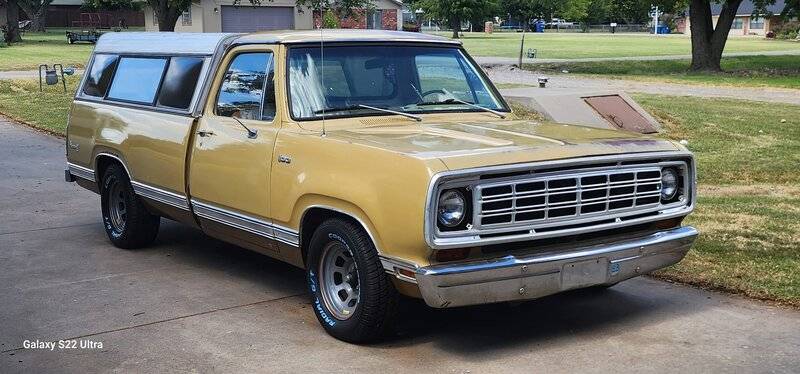

Some quick answers to a few questions:
The Truck: 1975 D100 Long bed 2WD... I will guess 3650lbs on the high side.
3.55 gears with 28 inch tire
Again, the 360 short block is an off the shelf reman 1978 360: Top end with consist of speedmaster heads that have been milled to 64cc and gasket matched. With Eddy Air Gap intake and probably a 650DP brawler. Headers and the Typical bolt on parts. I am pretty much sold on the XE268 Cam. I hope to make similar numbers as in Richards video.

I have to say, that is a nice looking truck! I love that color!
