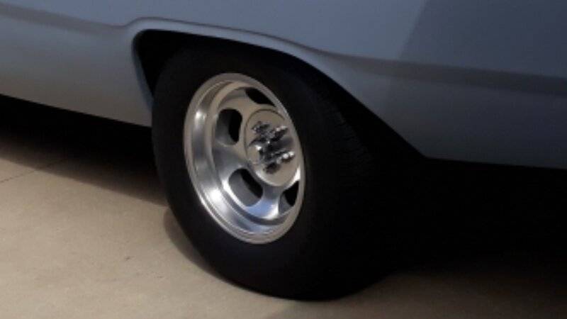

Do you have a picture of the wheel placement in the wheel well?
That isnt a bad idea I wonder if it would be enough to keep from shortening my driveshaft. Thst would be a cheap alternative. And two birds one stone!
The Nitto"s say they're 27 and 3/4 but the Hoosier slicks I had were 28 and we're much much closer. That's with the half inch block...
Any photos of the side of the car so we can see what 1/2" will do for tire spacing?
14" X 7" Aluminum Slots clearance to quarter, stock spring location.
