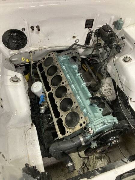

alright, I am going to try my best to document my re-build
it was a 225 with a Aussie Hurricane intake, Clifford Header & FiTech.
started tearing it down to re wire the entire car, upgrade the charging system, switch over to multiport injection and coil near plug ignition.
figured it would be easiest to tear it down and start from the ground up.
this will also give me a chance to look at that crack in the block and try and seal it up for now.
here are a couple pictures so far.
