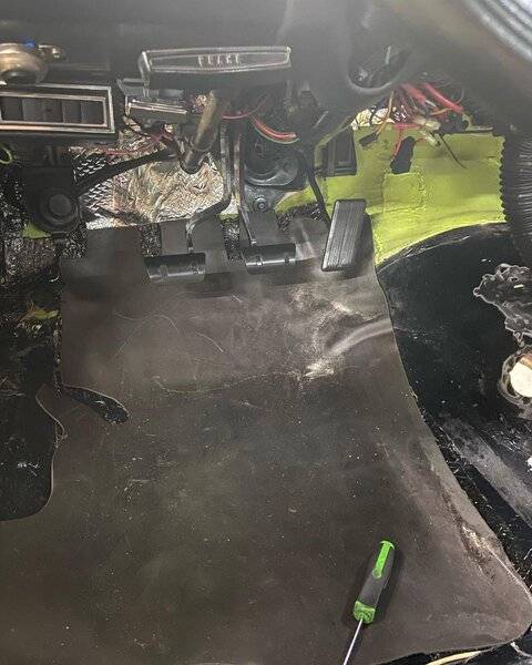

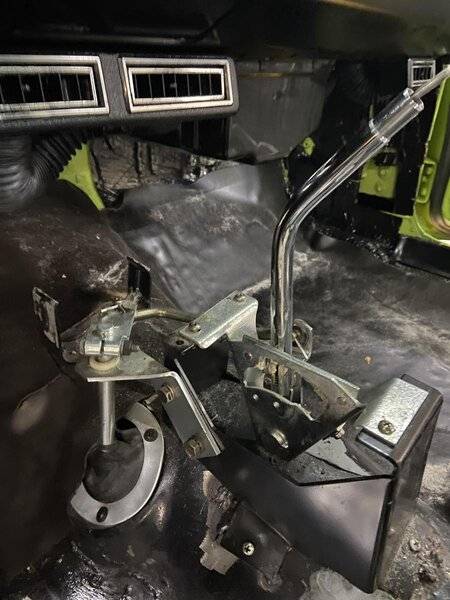

The shop that's doing the install sent me a few pics. I'm looking forward to being able to row the gears! I never liked the 727 transmission.
Nice! Interested to see how much crossmember or tunnel work there is, would think it should be pretty minimal.

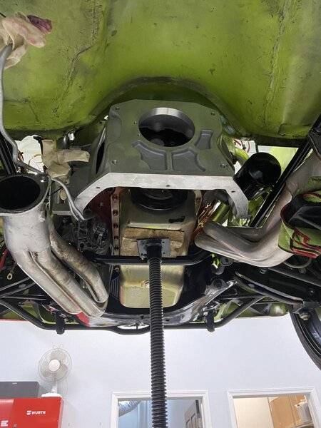

This is the only photo I have of the tunnel work so far.

Unfortunately, I don’t think it will be as small as it could be. Posted this in a different thread, but here are the instructions for the Holley crossmember brace.
https://documents.holley.com/199r12231.pdf
I’d post just figure 4, but it’s a .pdf and I would have to spend time extracting it.
Based on that picture, I bet the needed surgery could be small, but only if you can brace the crossmember under the trans like Holley is. The thing is, pretty sure they move the motor and trans forward so the SRV deal on the back of the 6.4 intake fits without hacking the firewall. But in the stock location I think the trans mount is inline with the crossmember, removing the option to add a bolted brace below the trans the way Holley does.
Which means a crossmember is going to have to be built above the trans much like the T56. I am sure it will be less surgery, but probably not as much as it seems.

The kit comes with a crossmember. Still, it's a lot of cutting to be done. The technician told me today that "it pained him" to cut into the tunnel. He's a bit of a Mopar purist. I'm not.

Huh. Yeah I still don't like getting rid of the upper part of the crossmember. Obviously it looks like they did a lot of work to the lower brace to make sure it can support everything it needs to, but for a torsion bar car that crossmember is pretty important.
I guess I shouldn't be too surprised, I know I looked into a TKO briefly when I was considering the T56 swap. I came to the conclusion that it was going to take enough cutting that I might as well just go a little further and install the T56. Plus the ToddRon crossmember for the T56 keeps the upper hoop.
One thing I don't like about that bolt in brace is (in my mind) it would require de-tensioning the torsion bars before dropping the transmission. I guess someone could ignore it, but I wouldn't.
