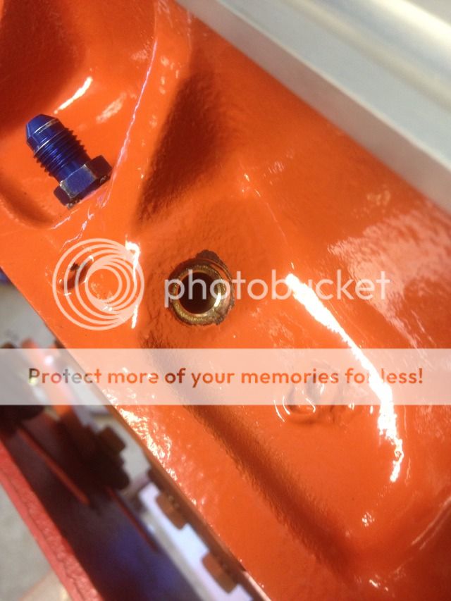

While getting my engine ready to go back in I had an "oh, ****!!!!!" moment. Broke off a brass plug in the rear oil galley. Had a brief panic then got my easy out workin on it. Thank goodness that it came out.

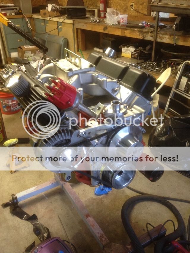

got the engine fully dressed and ready to go back in. just have to get the trans cleaned up so i can install it with the engine.

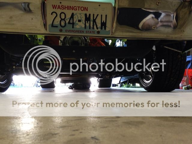

here are the header install pics i promised. I have room around everything. the lowest point under the car is my trans pan now.
Wow! The room you have now.......is just obscene. LOL. Great job. Been following this, keep up the good work!
