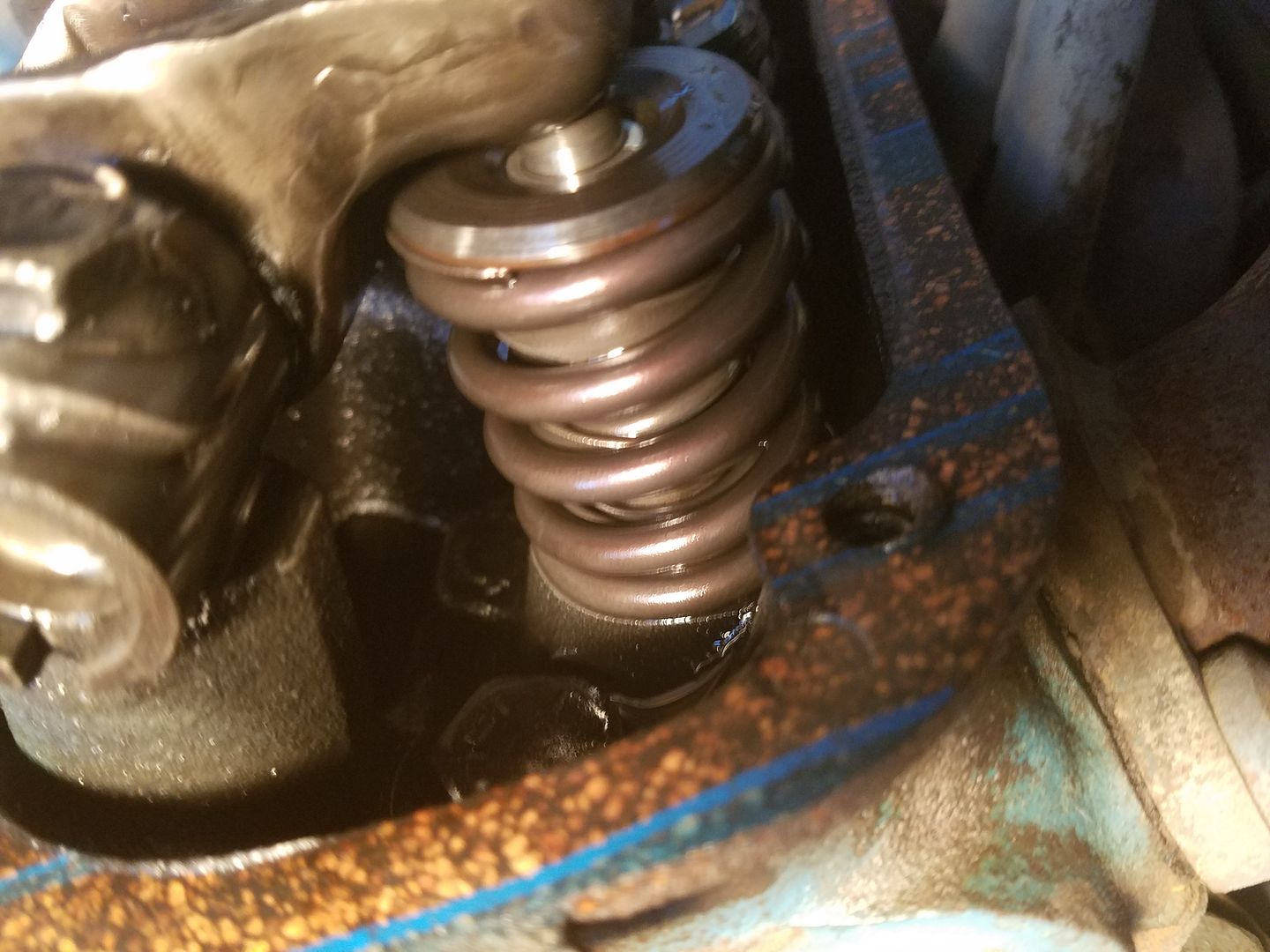

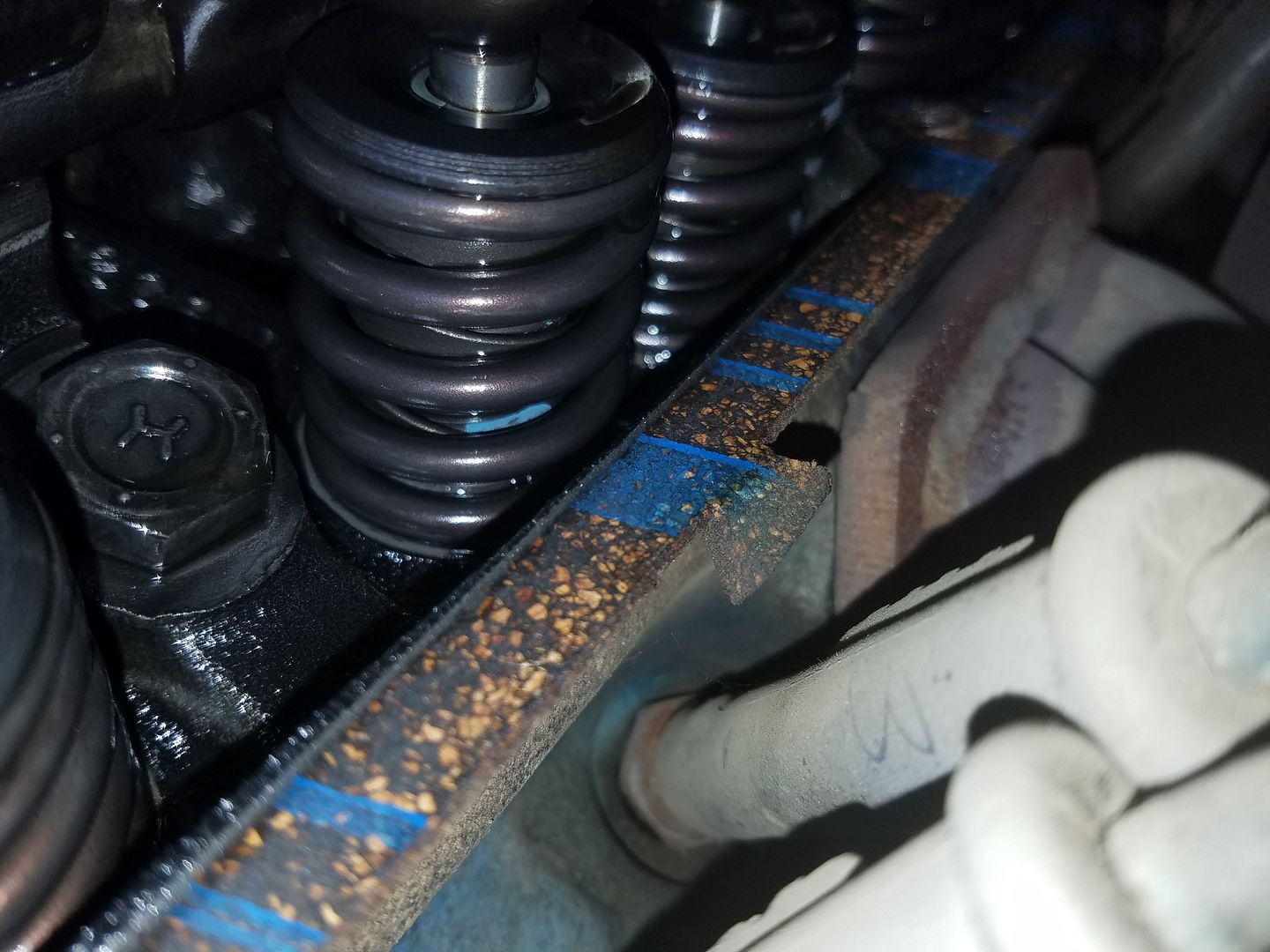

you mean cyl. # 1 spring ? cause that's not it if I'm seeing it right
oh, got it now :realcrazy:. Is it spitting gas up through the carb?

I agree with you 100 percent. I was going to do valve springs because of age and I probably still will eventually . I do not believe the problem is the springs. I decided this when I took the valve cover off last night and saw what I had. I agree that the fuel system would show itself more so under load. Not at light throttle free Rev.

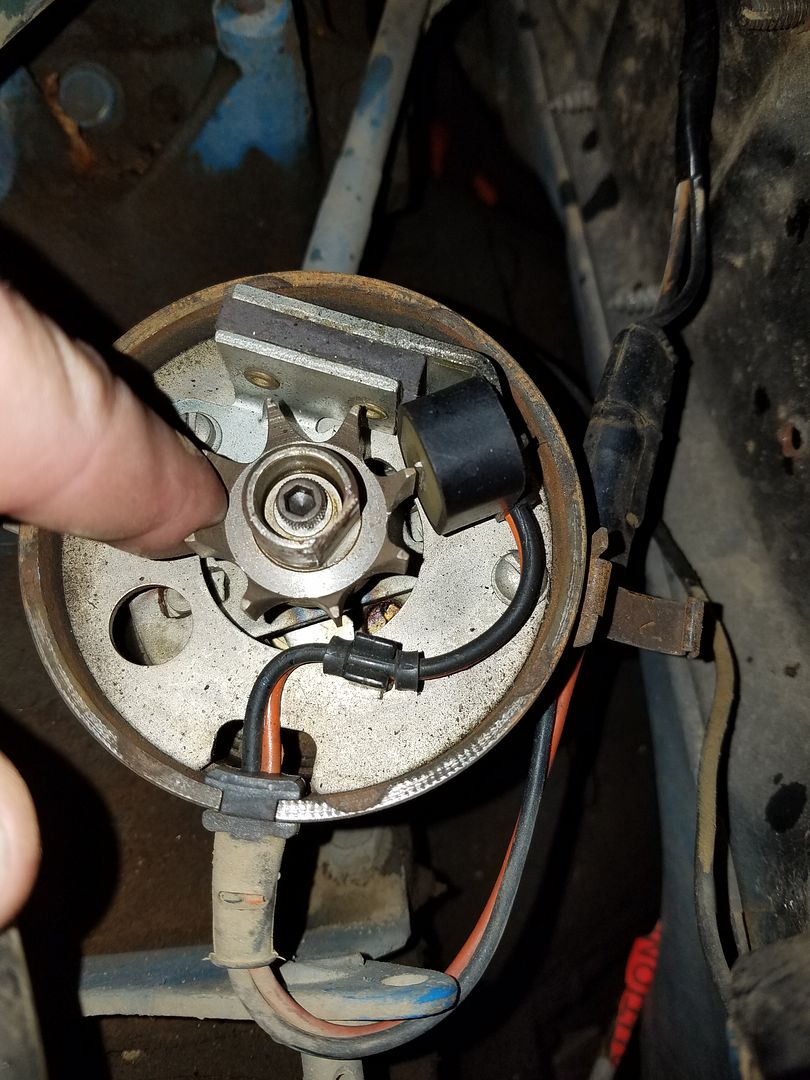

I just went out to look at the distributer and not sure for sure if it is a Chrysler stock unit. It is similar but not sure. Here is a picture of the pickup.
yep, I think it looks like a stocker. However, the problem could very well be starting after the electrical tape that I see on the wires. Also, the fact that somebody was in there and stuck the curve, well, there is another opportunity. the allen bolt is a sure sign of some down home country tuning :) .I think your sniffing the right trail, but I would start from the tape (i'm saying your after market ignition system).
Reluctor looks different than most I have seen. Maybe anot early model or a mopar ignition kit the distributor is a cable drive tach model. The electrical tape is my work. The wiring was a mess inside the car. I shortened and cleaned up a lot of wiring. I don't know the gap because I don't have my feeler gauges here. They at work in my tool box.

I am thinking the pick up coil may be the issue . Just to simplify it I will dig into my parts stash and see if I can set up one of my old Mallory dual point distributors. I set one of those up on a sun distributor machine and I had solid reliable spark passed 4000 distributor rpm. 8000 engine rpm.
