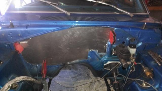

Thanks, I have a tall $$$$ mountain to climb right now, but the idea of 600+hp and 7000+rpm capability with a hydraulic roller on pump gas is alluring enough. I need to sell some more stuff so I get headers for mock up and building mounts. Then I have to decide if I want to repaint engine bay. Have been looking at some of you other guys with smoothed firewalls and no holes everywhere and I think I want that to. Been thinking about painting the engine bay the same B5 but with a satin clear.
Yep the engine compartment it under re-construction, couldnt see putting a trick looking new engine is my swiss cheese engine bay. Gonna re-do my core support and inner fender braces too. Plan to hide all the wiring and starter relay etc.

BB- just hold on,You'll be pleased when all is said and done,Take your time and get the right parts for you application,Nice job on the fire wall,gave me another idea--LOL,That motor will be a monster when all is said and done and you will be very happy,All my Mopar Guy's up here in the great state of Wis are pretty much pissed at me in a good way because they have $15,000 to $20,000 in there BB's and I have this (tiny) little stroked SB hemi that wipes them up at the track and I don't have $10,000 in mine,you will be VERY pleased when all is said and done--Steve
