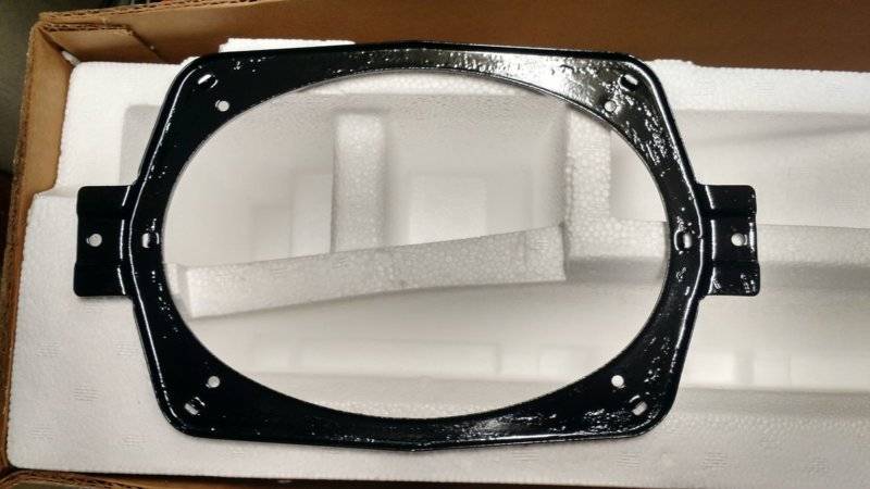

        Here is the old speaker and speaker frame. As you can see, under the speaker frame is a fine mesh. I have bought new speaker fabric at Jo-Anns, and will glue it under the frame before I mount the speaker under that again. On top of the frame is supposed to be something too. And from what I could find it must have been some kind of foam seal. But the sun obviously must have ruined it, and it was more or less gone. I have cleaned the frame, and painted it gloss black, as it was painted when it left the famous assembly line. A picture will come of that a little later.
        The speaker is as you can see in the picture, completely toast. It is a more or less regular 6"x9" speaker, but it is not very deep. It is a little difficult to just buy a new speaker of whatever type. One of the reasons is that they tend to be a bit taller, and that means they can reach down in the heater controls that is just under it. The one I bought is maybe a 1/4 inch deeper, and I really hope that turns out ok.
        However, the biggest issue is that most modern speakers has tweeters that sticks up in the middle, and would be too high. And the other issue is that most such speakers comes in a 2 pack, and you only need one.
        I was able to find a speaker that comes only in one, and here is a link to it.
        https://www.amazon.com/gp/product/B001RNNX76/ref=ppx_yo_dt_b_search_asin_title?ie=UTF8&psc=1
        I have no idea about the quality of it, neither mechanical or electrical quality, and I have no idea how it will sound either. But, I assume it will sound as good as the old speaker when that was new. Or maybe even better.
        It was cheap, and if it works out, I will be more than satisfied with it. I know it is not the original one, but I felt the old one was beyond what I want to repair at this point. But, I am not going to throw it away. It is possible to get new speaker cones and surrounds for repair. Usually not that expensive either. I have never replaced a cone before, but I have repaired my two larger surrounds for my home stereo. It just takes a little time. Both mine got very good, so I am not afraid of trying that if I have to. I have not tried to hook up the speaker to a working radio, but I have tried to hook up a 1.5 AA battery to it, and it kicks and make noise when I do that.
        Bill

        New speaker, old frame with fresh paint, and also the frame placed on top of the frame, the holes fits perfectly. Need to find some screws because the old ones does not fit in the new speaker.

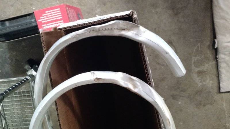

            So, it is either my left or my right lower control arm, yeah, it has be one of them, where the bumper is missing. And according to 1965 Dodge Dart Charger post #336 the bumper was changed, and I can only find the newer one.
            Now, what do you guys think, is it possible to buy the newer one and cut it off so it will look like the older one. And what is the implications of doing so ?

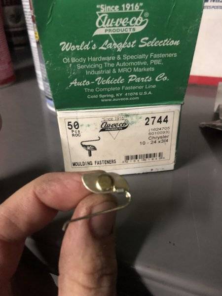

            I have not been able to find any screws and nuts for fastening the Candy canes and hood molding. Does anyone know where I can find that ? Does not have to be NOS, but have to fit and work and be new.

            So I bought these. They work great and I got a bunch of them lol. You will need to get nuts but those can be had at any hardware store

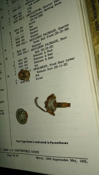

              Today I was looking in my parts book, and discovered something that puzzles me. Chrysler has one part number for the fastener screw, and one part number for the nut. When we took the molding of the hood at the junk yard, I will say it was an untouched hood. And it had the same fastener from one end to the other. But it had two types of nuts. It is supposed to be a #10-24 bolt on the fastener and the nuts on each end of the molding were regular nuts with a washer under. Have to look into that and see if I can get them cleaned up some for a picture. But, all the other nuts between those on the end was sheet metal nuts, those thin nuts pressed out of a piece of sheet metal. So, then Chrysler should have listed two types of nuts, but they don't do that.
              The fastener itself does not look like a Auveco #2744 either, they do not have that long thin metal spring. I have to see if I can find that too. I realize the Auveco #2744 will fit, that is not the issue, just wonder why it seems to be a discrepancy between reality and the parts book.
              So, where is the secret hidden here ?
              Bill

              On ‘66 Valiants I have also seen similar variations of different types of trim fasteners.

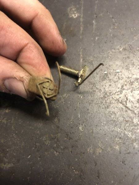

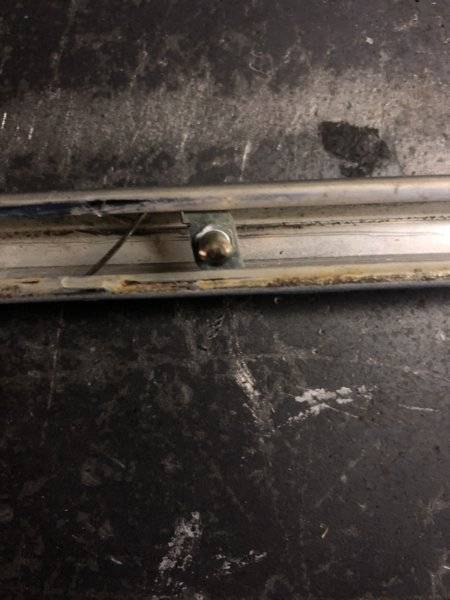

                Picture of oe and a picture of the aftermarket. Picture of it installed into the trim.

                I have not cleaned mine up yet, but I suspect it is the same ones as yours.

                Yes, they are in a moderate to low condition. :D I have searched the net all over, no luck in finding the right ones. Did you want to sell those you have left, and how many do you have ?
