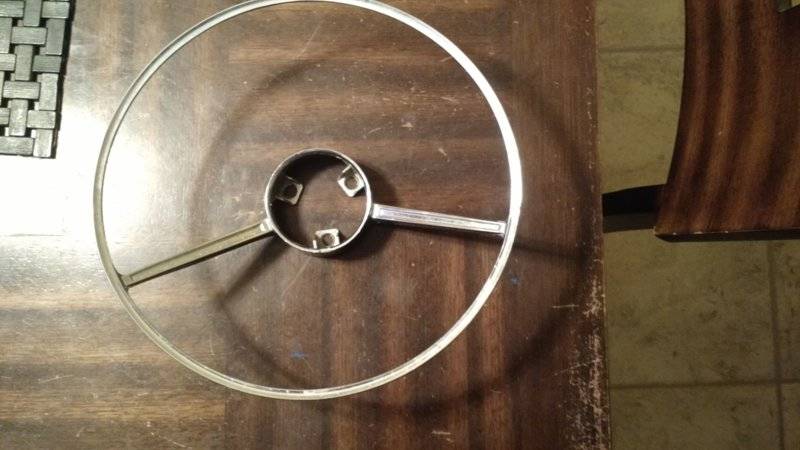

        Here is a horn ring I bought on ebay. It is not too bad, I can live with the little pitting it has, just polish it and be satisfied with that. But, the ring on the horn ring is bent on the piece that has the longest distance between the spokes and therefore support.
        How shall I go about straighten it, if possible ?

        Primitive but I think Bill had the same idea with the real part

        The horn ring is a cast unit no doubt.

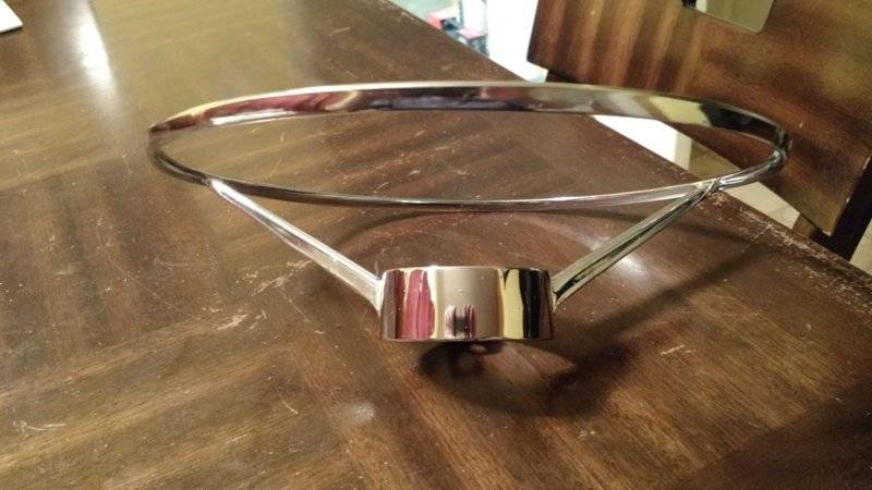

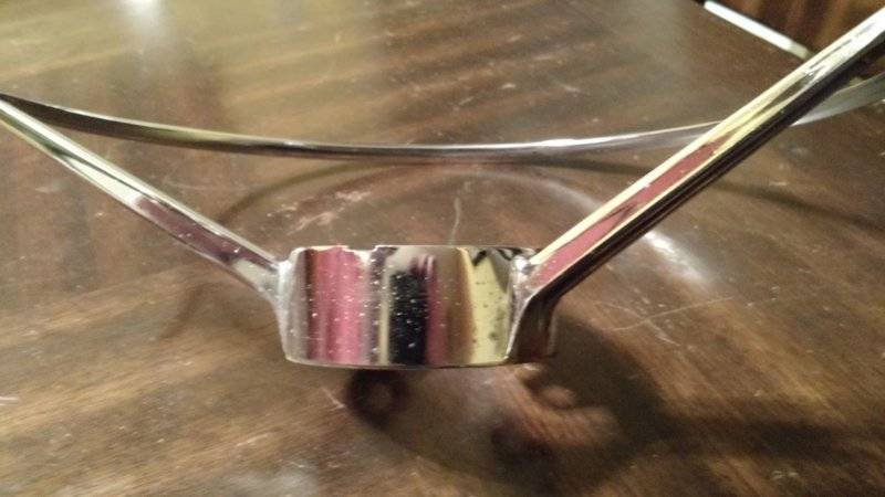

          Now I have straightened it, and it looks much better. I have still not polished it, I have nothing to use for that. But I am satisfied with the outcome and think I will let if be as it is. It is not 100%, but I will see how it looks on the car before I do anything more sophisticated with it.

            Looks good to me:thumbsup:

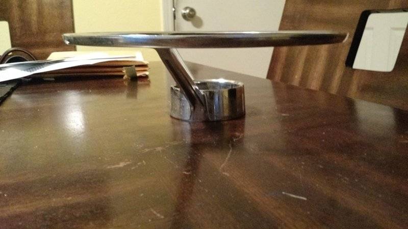

            Thank you. I used my Lappish/Sami boy wisdom, and my Viking strength. So I bent it with my hands supporting it on the table. I don't know if that was the right way, it was not at all scientific. I felt more like an artist. :D

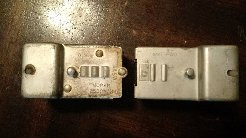

              Today I took a picture of my head light switches. Well, the left one with part number and date code was one I bought on ebay to get the switch knob, and it appeared to be a windshield wiper switch knob instead. The switch to the right, which says MO PAR was the one sitting in the car. The reostat wire on that one is totally gone, so I replaced it with a switch from Standard. So, that is what sits in the car now.
              What I wonder about is the MO PAR switch that was sitting in the car when I bought it, is that really a genuine MoPar switch, or some hubba bubba aftermarket cheating low life switch ?
              The date code on the one with a date code is too late for my car's production date which is December 30, 1964. But that is a whole different matter since I am not trying to get my car back to assembly line condition.
              Bill

              Went to Dave's Auto Parts and got a little bottle of Chrome Polish from Turtle Wax, and polished the horn ring. I am a novice at this but thought I got an ok result. Not so easy to polish over pitting. It is what it is, and I have to live with it for now. Not going to have it drilled and soldered and rechromed at this point.

                  The way I straightened the horn ring was perhaps a little risky I assume some will think. But I turned it upside down and placed it so where the spoke goes over in the ring was a little inside the edge of the table. Then I pushed down on the ring and released it, sort of to feel the strength of it. I moved the entire ring back in on the table to see if I had moved it at all, which I had not, then I moved it back on the edge, and tried a little harder. I took a hold of the ring a few inches from the spoke, and then in the middle, and then I placed the other spoke on the edge of the table and did the same. And used the same force.
                  That way it came a little by little, and finally I was satisfied with it. At least for now.

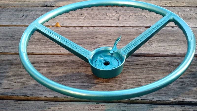

                    I realize that me and sanding / painting is not the best combination. I don't see what I am doing when sanding. I don't see how it looks like. Not until I have painted. Then I see all the mistakes. So, I sanded the steering wheel again, but this time I painted it so it is what it is. It is much better than the cracked thing I brought home, but the finish is sub par. But as long as I don't see what I am doing, it is not much I can do about it.
                    One thing I really struggled with is that the epoxy is totally clear. So, when I got epoxy on the steering wheel I see all the imperfections in the original resin in it. But, I do not see the imperfections in the surface of the epoxy.
                    Does anyone know if there is any black pigment to mix in Epoxy so the old surface disappear and I only see the top surface ?
                    I will post pics when the steering wheel is dry enough to take off the copper pipe.

                    When doing bodywork you do this by lightly spraying with a different color and sanding it off leaving paint in the low areas

                    I see, thank you for that tip. I am rather clueless when it comes to bodywork. But June approved of it, and she asked what kind of steering wheel was in it now, and I said a 13.5 inch GT steering wheel. Oh I hate those she said, I like the big steering wheels. So I told my wife she was my kind of woman.

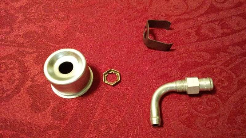

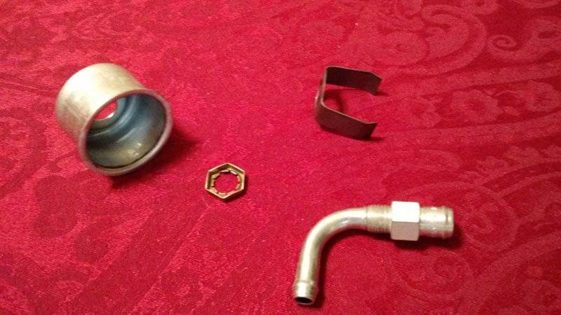

                      Yesterday I tried to put on the brand new PCV valve I have. I bought the valve itself from one place, and the cup and spring from a totally different place. The old PCV valve was not there when I bought the car, it is just like a second oil cap there.
                      Anyway, the cup in question was advertised for a V8, but since they looked the same I assumed they where the same. I sort of could not imagine Chrysler changing the size of the tube for something like that.
                      The new cup does not fit. It is too tight and does not go over the tube on the valve cover. If the diameter of the cup had been 1/32" larger in diameter it would have slid right over the tube.
                      So, does anyone know what is the issue here ?
                      Did Chrysler really have two types of cups and valve cover tubes, or is this just a part that is made wrong ?
                      Any help is appreciated.
                      Bill

                      Only one size and 2 different caps, one painted and one chrome.

                      Thank you. So, in other words, my cup is just a crap useless part.
