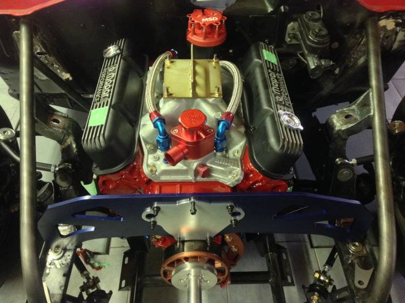

Lol this will perk you up. Got it in the car yesterday.
