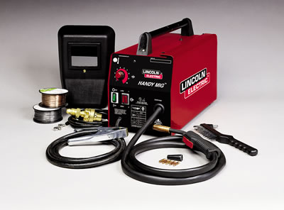

I have a few questions, it has been about 15 years since I last used to weld, it seems that I forgot everything I knew about welding.
I recently bought a small Lincoln 110v welder, I am usung pure C02 with it. The issue I am having seems to be dirty Welds when I was welding up some 1/4 holes, the smaller holes looked fine, but the beads are sticking up to far, I have to do a lot of grinding to get them flat. I have the regultaor set on 30psi for the C02, which was recommender my Lincoln tech support.

I have the Handy Mig, which a slight step down from the 100. It was a christams gift, and all I have ever used it on is exhaust and sheetmetal.
Yes I am using .024 tip and mig wire. Came with the welder from Lincoln.
