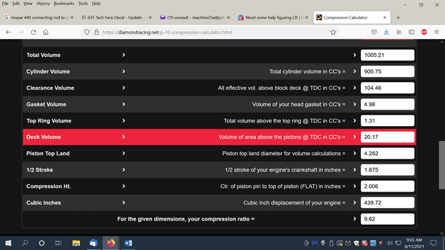

I come up with about the same CR (9.62) using a different calculator and making some minor assumptions such as head gasket bore and top land thickness.
