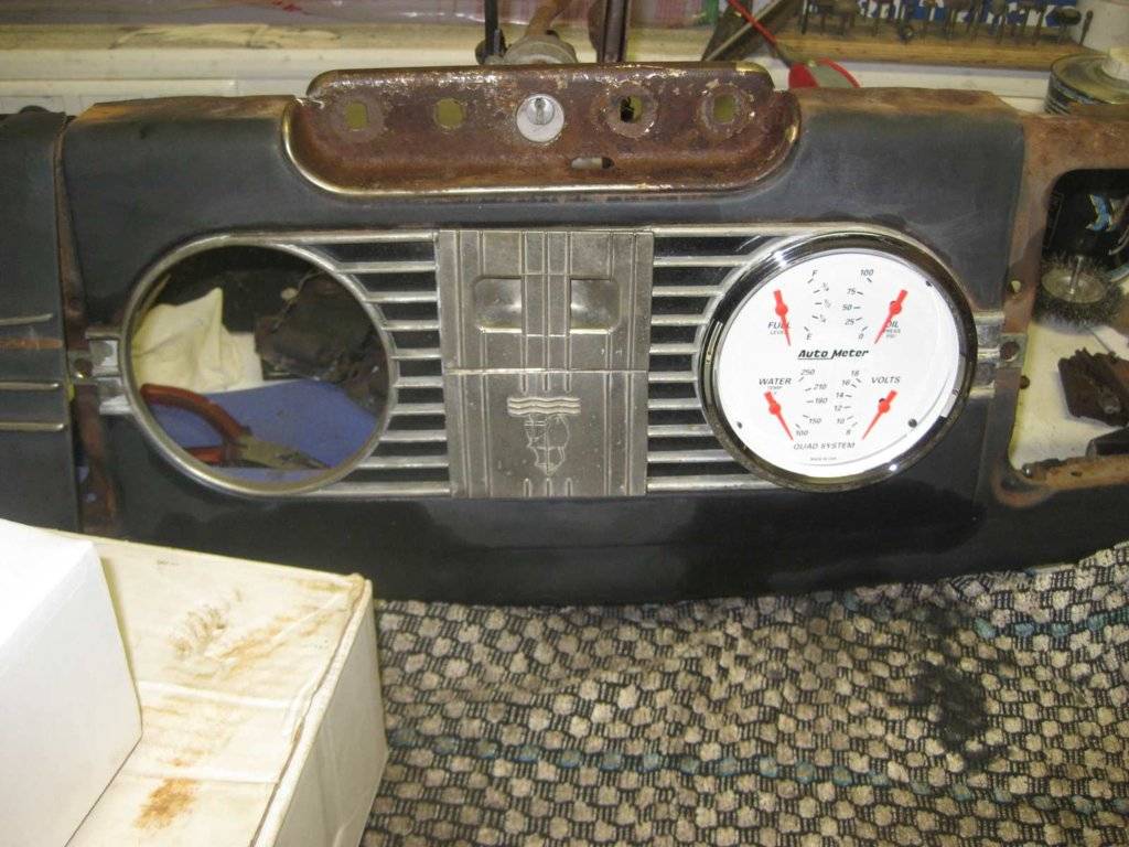

dash is remounted and the new gauges sit very good in it ( for a first check ) !

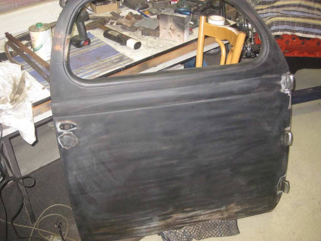

Hi Guy´s :
it´s time to write what is done on the 1938 since 2017-february:
Car is parted out carefully, the grille is overhault, fenders and chassis were sandblasted and now they´re painted with POR 15 ( inside ) and out with a epoxy paint as a base for the later coloring.
Rear axle is also new painted and was installed under the frame last weekend.
Next will be : overhauling the doors with new glas and rubber, also with power windows
I´m awaiting also the new sheet metal for the back side and the rocker panels...these are verry rusty...

Very nice work on a great car. Your 38 is a P6 though. The P5's didn't have vent windows and the 3 bar trim around the gauges. Keep the pictures coming. I wish my 38 sedan was that far along. Keep up the nice work!
