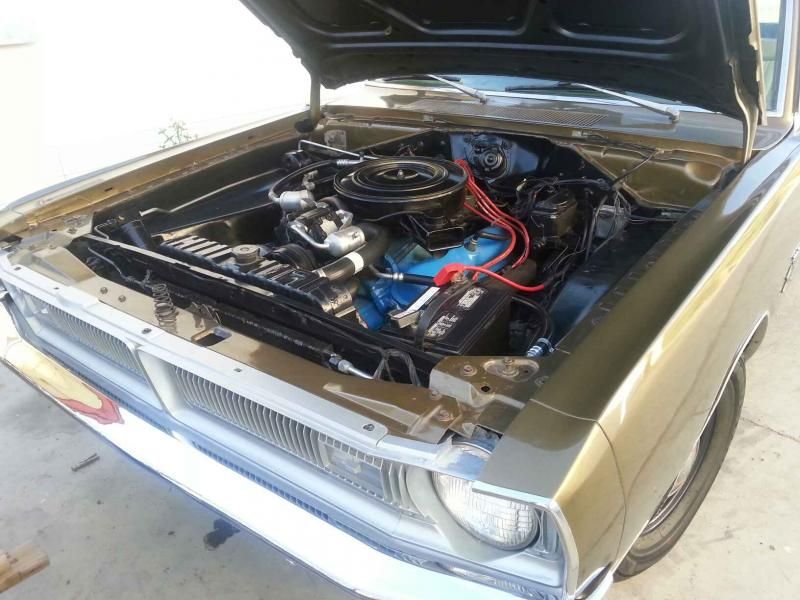

Started as a stock 318/904 with 8 3/4 rear. Paint was just done 3 months before I purchased it, and the reason the guy sold it, was because he ran out of money, and it needed to just go.

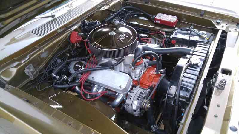

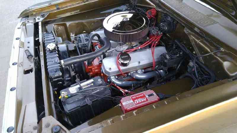

IMM built 408 with W2 race heads with:
K1 crank and rods
Diamond pistons CR 10:1
Comp custom grind cam 254/260 at .050
.698 gross list with T&D 1.6 Chromoly rockers

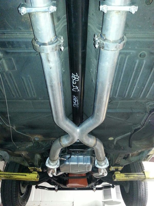

TTI 1-7/8 headers, X-pipe 3 inch to Super turbos, 2.5 tailpipes
Magnafuel 275 pump with return and their 2 feed regulator
1/2 pickup sending unit, with 1/2 bulkhead fitting return in stock tank
Holley 850DP
20/34 timing through MSD box/dizzy (no advance)
runs on 91 octane just fine
904 I built with the typical Red's, TF-2, with some of my own tweaks, and TCS Canada 3K stall converter

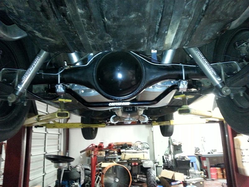

3.55s(clutch LS) with 275/50-15 Nitto Drag Radials out back, stock up front for now
K-H front disks (Mustang rotors in the shop to go on soon)

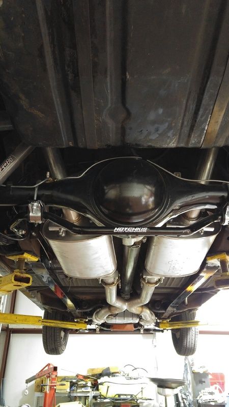

Dr Diff axles, 10.7 rear disks Cobra calipers w/park brake
Espo springs
Hotchkis Fox shocks, F&R swap bars and sub frame connectors

1350 yokes on the 904 and the 8-3/4. No cutting corners here.

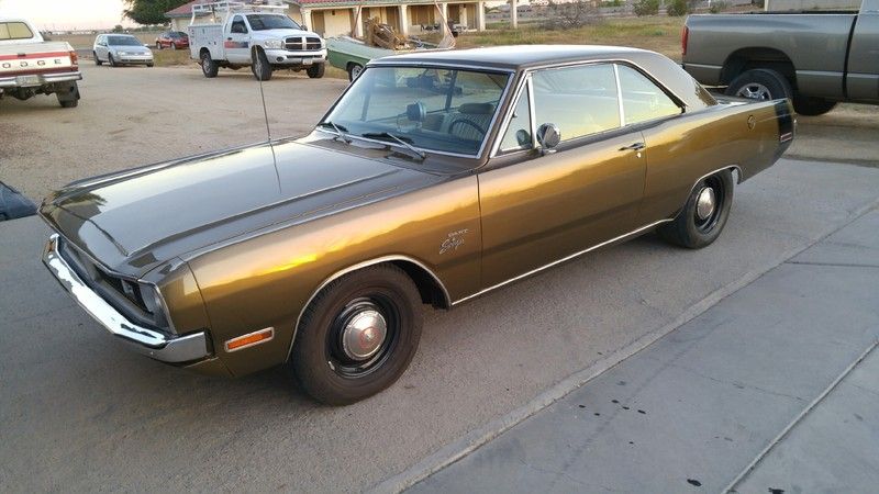

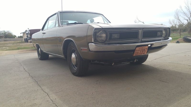

Had taken some more recent pics for insurance appraisal, so might as well share them.
One of the subframe connectors
Some Engine shots:
Some exterior

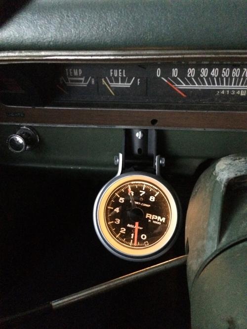

Here's a before shot of driving with the bright LED backlight. Hooked up an Autometer dimmer and I still need to take a night driving shot.

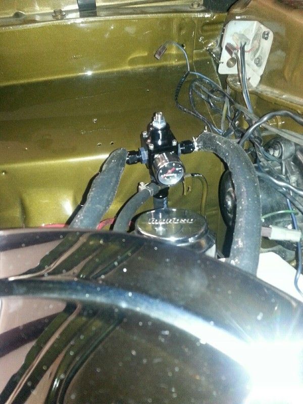

Magnafuel setup and regulator. Installed 1/2 bulkhead fitting in tank for return. 5/8 feed to secondary 10micron filter, then dual feed 3/8 line regulator to carb. Currently set at 6psi, and everything seems happy.

Love what you've done with it! I think your tach is the biggest give away. I've got mine down on the dash by my left knee. Ricers around here don't seem to pay attention to the big tires or the sound. They sometimes ask if it's missing lol!
Walker434, any shots of how yours is mounted. Sometimes, I don't care for it up high, and with my shift light being the backlighting, it's very easy to see the color change.
No I'll try to take a few pics tonight.
