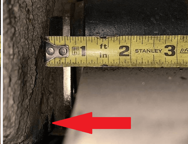

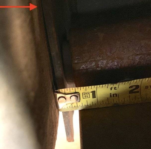

And here are the pictures again
This is a stock offset front spring hanger, notice there’s actually just under a 1/2” from the frame to the hanger. There’s undercoating there, so it’s a 1/2”. You can also see that the edge of the leaf spring is just shy of 1” from the frame rail.
This is an MP 3/4” front hanger
You can see that the top corner of the hanger is flush against the frame rail. There’s a small gap at the bottom because there’s a slight taper on the frame rail. And you can see that the edge of the spring is just over a 1/2” from the frame rail. That’s a rubber spring eye bushing, so there’s a bit of give there.
So you can CLEARLY see that the MP 3/4” offset kit is not a 3/4” offset, the front hanger only has a 1/2” offset and only moves the spring in a 1/2”.

Not wrong. The 3/4” kit will never be a full 3/4” offset because the MP kit front hanger only has a 1/2” offset. You can literally measure the hanger itself, it only has a 1/2” offset. And that’s because the frame rail is only an 1/2” away from a stock hanger. Only the shackles have a 3/4” offset, which puts a 1/4” of bind on the spring.
I have the MP “3/4” offset kit on my Duster. The front hanger is only a 1/2” offset. This is because with the stock hanger there’s only a 1/2” between the inside of the hanger and the outside of the frame rail. So, unless your frame rails aren’t in the stock location, you’ll never get a 3/4” offset on the front hanger.

Believe what you want to believe, but it doesn’t matter if you have an MP kit or a home made hanger, there isn’t 3/4” of space to move the hanger.
The MP hangers on my car in the picture above are in contact with the frame rail, and required a hole and a dimple in the frame rail to clear the nut on the outside of the hanger. Unless you sectioned the hanger into the frame rail, there’s no more room on your car and the springs only moved a 1/2”.
Just take a measurement from the frame to the spring. In order to have a 3/4” offset at the front hanger there would have to be only a 1/4” from the spring to the frame. The spring eye bushing is a 1/4” thick there, so, that would mean the bushing would have to be flush against the frame rail.

I'm not gonna argue with you, anyone that can read a measuring tape can figure this out very easily themselves. The pictures of the MP brackets literally butted against the frame rail and the measurement to the spring being a 1/2" different from factory should make it obvious that you can't have more than a 1/2" offset on an A body unless you literally sectioned out the entire part of the frame rail that overlaps with the hanger, so that the inner part of the hanger could be where the factory put the outer wall of the frame. The hangers would have to be inset almost a full 1/4".
The MP springs require exactly the same thing as what you described for your hangers.
Feel free to measure your own car, and post a picture of the distance from the inner edge of the leaf spring back to the frame rail. For your car to have a 3/4" offset on the spring hanger that measurement will have to be no more than a 1/4". We've had this discussion before, you've never posted any evidence that would suggest you have the only 3/4" front spring hanger ever made. Which you'd need, because the 3/4" offset MP hangers are only offset a 1/2".

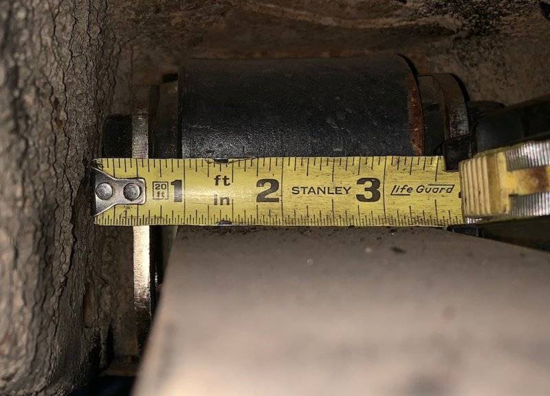

You're car is slightly different than my '68. The rails on my '68 are much more vertical than yours, especially as it approaches the outrigger/floor support. I also cut the mounts where the lines are below. This eliminated the slight taper issue. Like I said, it's a lot more vertical on mine right at the outrigger and only tapers slightly away from it.
That small overlapped flange was the limiting factor for me. It's not a gusset - at least it wasn't on my '68 (or my '66 for that matter). It's a flange for attaching the outrigger to the subframe. When I cut it off, I replaced it with a complete weld. Plenty of ways to skin a cat. At the end of the day, I was able to redrill the mounting holes 5/8" inward. Doubtful that extra whopping 1/8" even mattered. Probably not.
I'm installing the Dr. Diff kit on my Duster this winter. Here is the current clearance between the spring and tire. Looks to me like 5/16" I'll take another measurement when I'm done.

Same thing you've said every time. Measure them. Post a picture.
Unless your frame rails aren't in the factory specified location, a 3/4" offset of the front hanger from stock will put the hanger inside the frame rail. If you didn't do that, well, I don't believe for 1 second your springs are actually offset 3/4". But as I've said every time, measure it, take a picture, and prove me wrong.
Either way, if your hangers aren't MP hangers, stop commenting about the MP hangers actually being a 3/4" offset. They're not, you can check the pictures above and see that plainly.

For the MP kit, it doesn't really matter a ton how the cars are different. The front hanger is built with a 1/2" offset compared to stock, it's easily measured. The offset shackles in the MP kit are offset 3/4". Even if you weld the spring perches at a 3/4" offset, the front hanger is still only a 1/2" offset from stock, so you're not going to get 3/4". 5/8" maybe, but you're still putting the spring in a bind. Will it cause some catastrophic problem? No, but it's better if everything lines up.
The fact that there's only a 1/2" between the hanger and the frame rail to begin with is just icing on the cake, you can't put a 3/4" offset on the front hanger and not have it inside the frame rail. Now, is every frame rail perfectly aligned with the factory spec? Of course not. But if you're MP, you can't build hangers to sell based on the anomalies. And even on the cars that aren't perfect, well, they're also not usually the same side to side.
Maybe Bob bought a custom set of 3/4" offset hangers and both he the guy he bought them from happen to have cars with frame rails that are 1/4" further in on both sides. Unlikely, because that's well out of even factory tolerance, but never say never with Ma Mopar right? But that's not what Bob said to begin with, he said he had MP hangers.
Regardless, the MP 3/4" offset kit has hangers that are only offset a 1/2". If Bob would like to measure his spring to frame distance to show his springs really are offset 3/4" and prove me wrong, I'd love to see the pictures.
