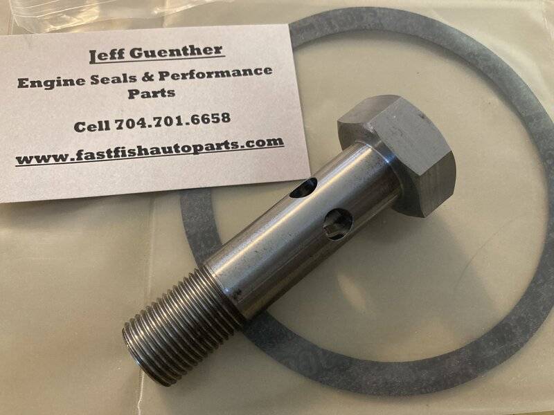

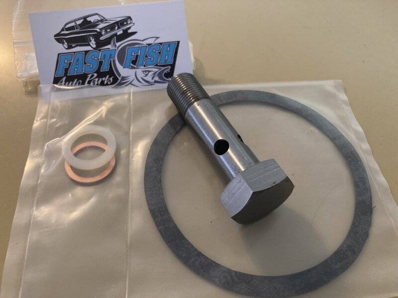

Here are the copper washers that I use between the bolt head and the adapter, instead of the fiber washer. I've never had a leak since I started using these. You will need to hone the ID of them out just a touch so they slide on the bolt easier.
