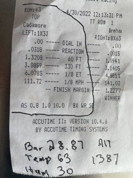

Ok now I’m excited. I didn’t expect that.

First pass in 18 months was a dozy. New engine and transmission I built, a converter just back from being freshened, and a brandy new APD alcohol carb that all I did was go down 4 jet sizes. I’m shocked at the very first pass.
Which heads are on that one?
Been over the scales yet?
It was 2880 with the R3 and this is a stock block. But the driver gained 25 pounds. This is my old set of 2.08 open chamber Edelbrock heads that I did years ago and the nicest Victor340 that I’ve done to date.
The only thing I messed up on was I forgot to hit the damn record button for my RacePak. If it was a bad pass I would have been pissed off.

Lol my whole 2 acres is a hillside and I fell in love with the wrong house back in 1985. I had an open trailer back then so it wasn’t a big deal. Sorry but I can’t tall you the temps as I forgot to hit the RacePak record button and didn’t look. I had it 175 leaving the lanes to do my burnout so I’ll guess around 180 at the end of my pass and 170 by time I got to my pit spot.

First pass in 18 months was a dozy. New engine and transmission I built, a converter just back from being freshened, and a brandy new APD alcohol carb that all I did was go down 4 jet sizes. I’m shocked at the very first pass. View attachment 1715920262
I`m not familiar with 1/8mi times, what would that equate to at 1/4mi ?
