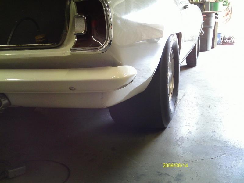

here are mine the are 31/10.50 15's on a 15x12 aero race wheel. no axle or rear suspension yet, but you get the idea. they are up in the wheel wells (after a mini tub) so they will fit just fine. we also had to widen the wheel arch slightly.
