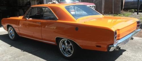

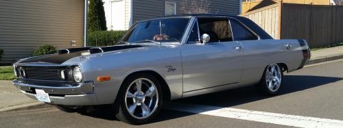

1972 Duster
Stock 8 3/4 abody rear
Espo +1" rear leaf springs in stock location.
Original Kelsey Hayes front disks and rear drums
MonroeMatic shocks
NO fender or wheel well modifications.
Front -
Crager SS
14 in. x 7 in., 5 x 4.00 in. Bolt Circle, 4.125 in. Backspace
Cooper Cobra 225/70R14
Rear-
Crager SS
15 in x 8 in., 5 x 4.00 in. Bolt Circle, 4.25 in. Backspace
Cooper Cobra 275/60R15
(3/8" clearance to leaf springs)

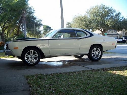

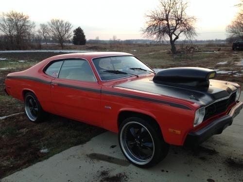

Front
Wheel Brand- OE Wheels
Size- 20 Inches
Backspacing- 4 1/2"
tire size- 255/35/20
Suspension mods- stock for now
Rear
Size- 20 Inches
Backspacing- 4 1/2"

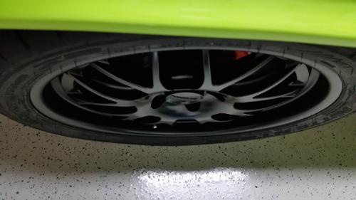

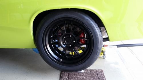

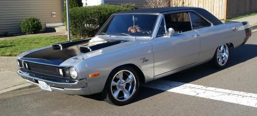

Front
Wheel Brand american muscle bullitts
Size 17x8
Backspacing 5.72"
tire size
Suspension mods fat man spindles QA1 shocks
Rear
Size 17x9
Backspacing 5.72" w/ 3/8 spacer
tire size 275-40-17
Suspension mod custom made 2" drop blocks by me w/QA1 shocks

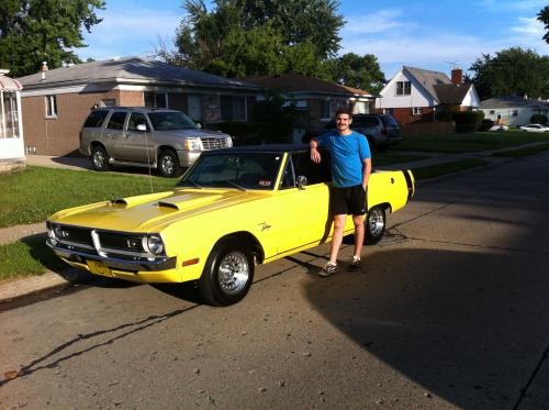

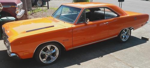

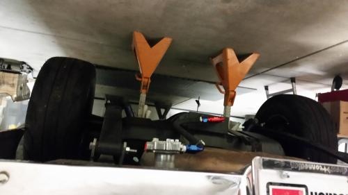

Just got my mt streets on today 325 are tight but I could get my finger in just past my fingernail at the outer wheel lip. May have lost the beater hub cap look lol which is totally what I was going for. Nwdart
Nice!!!! Me likey.
