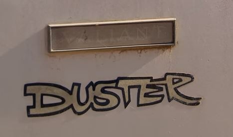

Here's the 70 Duster like mine. "Valiant" emblem with a Duster sticker below. on a 71 it would be the same sticker but w/o the valiant emblem.
His car has a sticker like this. Looks totally original. Wish I had a better picture of it.
