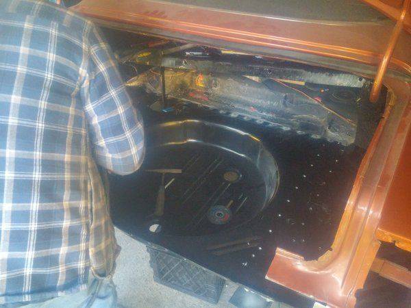

heres a couple more pics , first the jedi master takes the torch ,second up is a good evenings work and the floor is in , tonight we do the crossmember and the seam on the passenger side extension , after that it will be the Valance in a couple of days followed by some priming , sealing ,undercoating and re-assembly so it will be a roller again while I do some engine work and the final body and paint to the valance .

Thanks Pauly , welded in the crossmember and the passenger extension last night so the end is in sight finally hopefully 1 more trip esrly next week and the welding will be done .I don't have a painter lined up but being it' only the valance and half of it is covered by the bumper I am probablt going to maycj a couple of rattle cans and have at it myself lol

Thanks I fabbed a replacement support panel for the package area floor today and fingers crossed Monday night all the welding will be done leaving a little body and paint on the valance and some re-assembly . Sure will be nice to get the wheels back under it again .

Well the good news is it's all welded together including all the support brackets and the trunk lock tower , heck the trunk latches and everything lol . Now the bad news ........I got a butt load of work to do sealing , coating and putting it all back together plus body and paint on the valance , I'm going to be a very busy beaver .

Pics will come this afternoon , still a long way to go and a big thsnks to Inertia and his son Chris for all the welding .I too like a frosty Corona on those very rare occaisions that I imbibe .

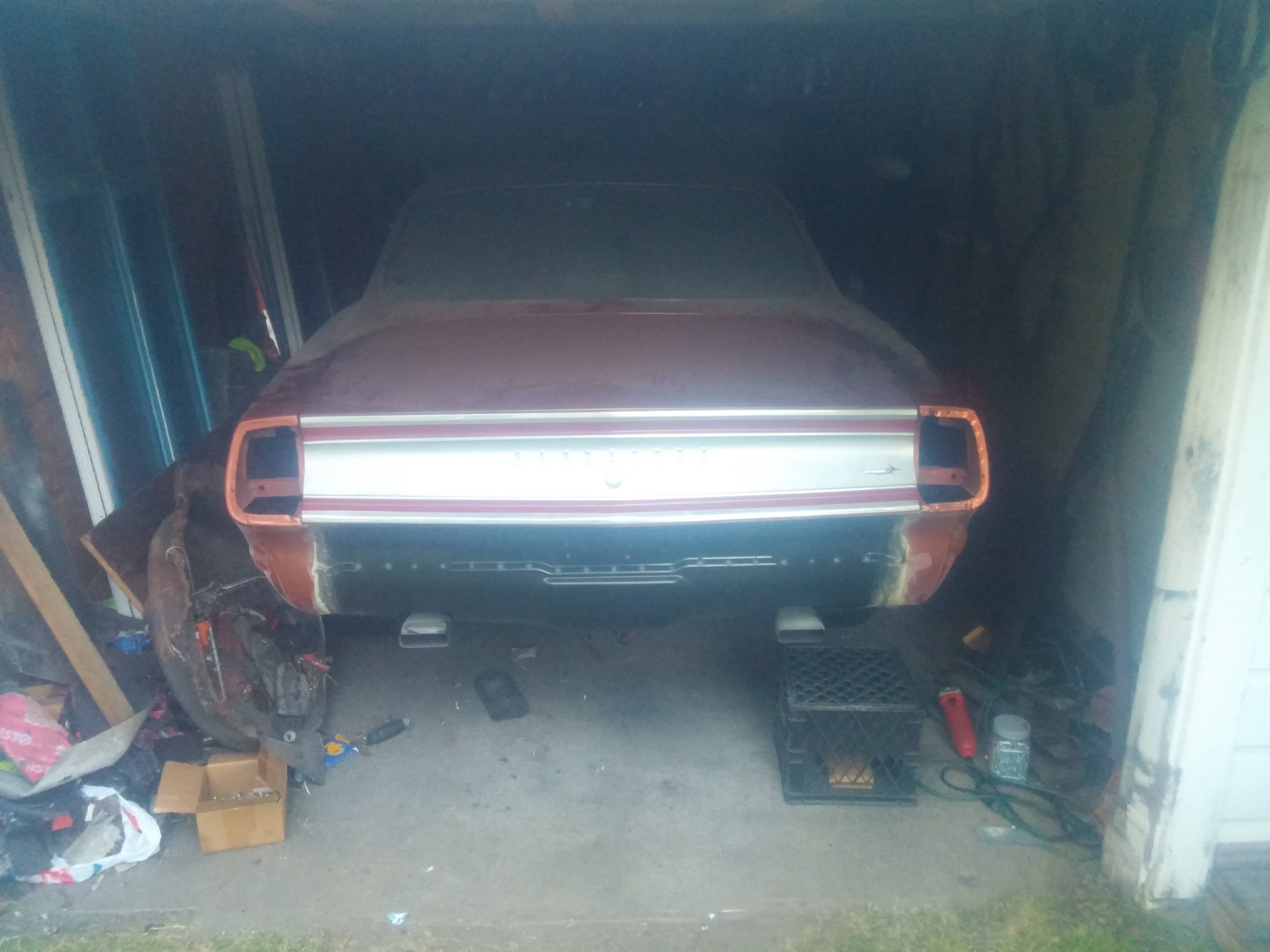

alright heres the missing pics from the past week ,
1st a coat of epoxy everywhere
2nd ready to weld
3rd the young Padawan surpasses the jedi master
4th the valance is in
5th the homemade support piece
6th the lock tower and bumper brackets are in
7th look the trunk locks properly yippeee.

It was a pleasure to do.
Cannucky had it well thought out and all the pieces of the puzzle were well trimmed to fit, so there wasn't any messing around.
Top notch work and fabrication, great attention to detail.
Certainly a job to be proud of..
Now if we can just find a decent color mixer and painter..
