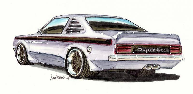

I am thinking about something like this, for right now though I am going to shave chop and tuck the stock one. I will shorten it to fit a lot more like a '71 demon bumper and also shave the bolt holes.
attachment.php
wow did u draw this? this pic is great, i wish i could draw like that.
