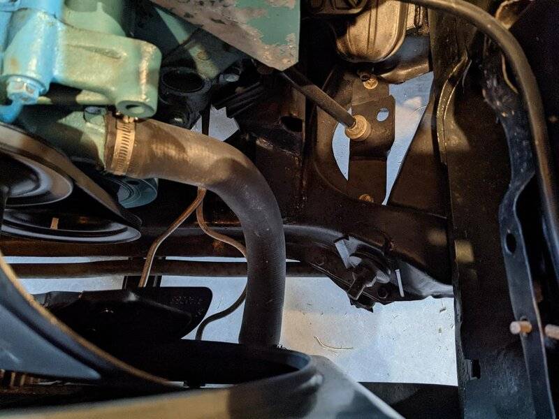

I have a 69 340 with lower water pump hose on drivers side. Manual steering. Will your AC bracket work?
My 340 has the same left side lower hose as yours. I bought Denny's bracket and plan on changing the water pump and the radiator nipple location to the right side to give the AC pump room.

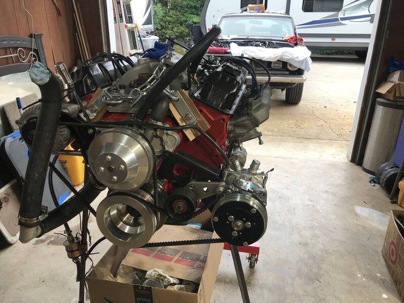

I moved my A/C mock -up assembly yesterday....lightweight compared to the boat anchor OEM piece. Wish I could loose weight and look good that easy.

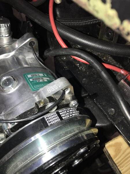

Can you use the Sanden 508 with your Bracket? I don't see where you mentioned what type of Compressor you are using.
If the 508 will work, I'll take one if still available!
