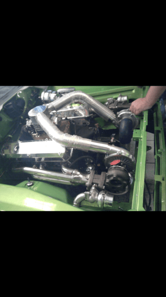

On the early As we only have about 3.5" between the exhaust face on the head and the inner fender well. Drivers side should fit though. Maybe these will work for you guys with 67 and newer Abodies.
sireland67
Oct 27, 2010
10,108
5,688
WV
The picture of the white card stock is 5". The engine compartment is a 73 Duster.
I don't think these will fit any A body car.
sireland67
Oct 27, 2010
10,108
5,688
WV
They will also be tight in a E body, I just checked with the same piece of card stock, looks like they are going to be close to the shock tower.

I measured my 67 Belvedere with a 360 and there isn’t room on passenger side for 5 inches here either. Dustin

the only info i could get out of them was "these were built using a 318 dart" so hopefully they will fit A's. I'm personally using on a B-body. I could fit another smallblock beside the one thats in it :p

I'll be over at my shop in the next few days, i'll take them with me and see if there's a chance they will fit. Even looking at my B-body, the alternator appears it needs relocated.

I think these may actually fit on a A body.
I was just mocking my engine up, had to grind a corner on one so the spark plug can be removed.
They actually raise up, I think they will clear the shock tower.
The alternator you will have to get creative, I think I can cut and add some 1" stock to the alternator bracket, and run it from another bolt hole to make it work.

i ironically have my headers unbolted on the race car... i could mock this up pretty easy in the car.
sireland67
Oct 27, 2010
10,108
5,688
WV
Give it a shot, I have no intentions of using these in a A body. But I will post pics when I get them dropped in a E body.
subcom
Sep 17, 2010
1,597
869
South Florida
That #6 pipe will be the make it or break it factor. Just eyeballing it against the flipped Dakota shorty headers that interfere on the #8 pipe, these don't look to be hanging as low. My fingers are crossed for you. They might just work. Thanks for sharing the install pics!
