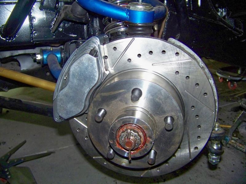

OOooowww Shiny. I picked up these lightly used Wilwood Machined 4 piston calipers for next to nothing on Ebay. The piston diameter specs out and will work for what I need. They even came with new pads. I love late night ebay deals. It's a win, win they clear the early sway bar tabs no problem and they weigh only 5 lbs each compared to the 14 lb factory one piston calipers. That is 18 lbs of unsprung weight removed from the front suspension. I will machine some aluminum brackets to mount them, similar to the AR Engineering brackets.

Lookin good!
Thanks Louis. I plan on running new steel lines with a proportioning valve under the drivers seat and have the front lines pass through the frame rails with stainless steel flex lines to the calipers.
