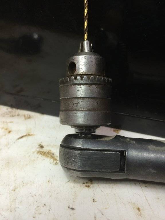

My solution for an angle drill.broken 1/4”extension. Put a square drive male in the lathe and turned the female part to 3/8”. Threaded it to fine thread and away i went. The threads actually appear in the corners, but when in the chuck they are supported. A bit of locktite and it is the ticket.

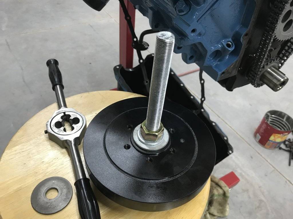

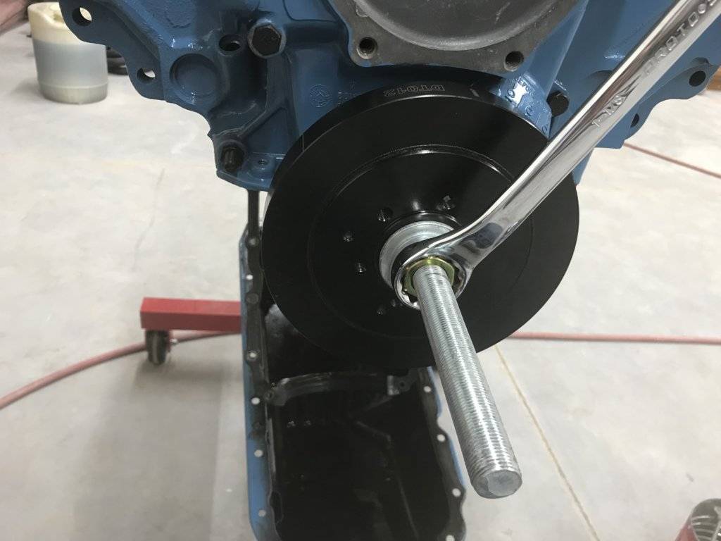

Probably been done to death here but I didn’t look through all of the posts. Very common but simple and basic home made tool for installing harmonic balancer. Technical name for it is “Harmonica balancer putter-on’er”. I had enough rod that I made three of them if anyone needs one. After I finished I found one in a box of junk that my dad gave me with the car. I thought “oh that’s what that is for” haha now I have four.
I "almost" did similar back in the seventies. Had a tight spot. Don't remember "how" I did this "It might have been" Proto 3/8 drive allen bits used to have an allen set screw so you could pull the bit and change the thing. May have been one of those or a junk socket. Anyhow I think I brazed a bolt the correct size to screw into the rear of the chuck, into the drive. Was not nearly as short as yours!!1

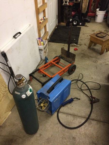

The year was 1995 I was 11. My grandpa asked my dad to come with to a sale at the hardware store. I begged to come with. My grandpa said they were leaving at 5am to make sure he got this welder. We were the first ones there.
Before he passed away he gave it to me. (He passed away in 2007)
It needed some parts but I was able to locate them from the local runnings store.
I’m not the best but I have some buddy’s that weld for a living to give me crap (aka steer me in the right direction)
View attachment 1715157084 The year was 1995 I was 11. My grandpa asked my dad to come with to a sale at the hardware store. I begged to come with. My grandpa said they were leaving at 5am to make sure he got this welder. We were the first ones there.

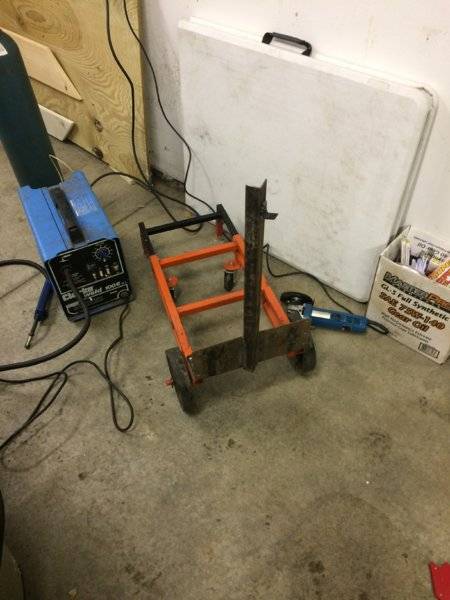

This one may not be much use on a-bodies, used to remove and install hood springs, B, C & E bodies.

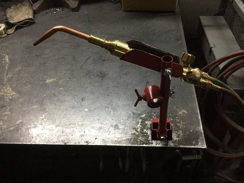

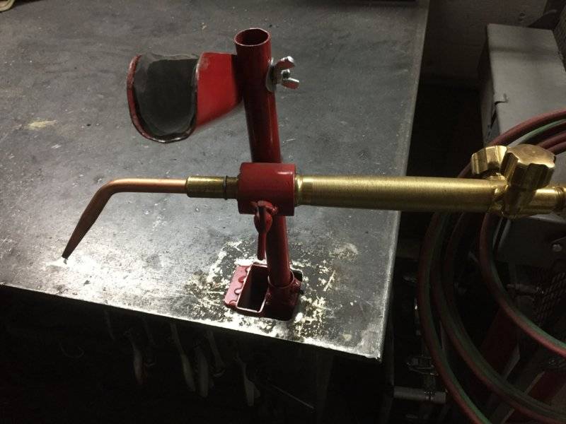

Got tired of shutting my torch off because it would seldom lay on my welding table without twisting and trying to burn something. I built this holder that fits in a receiver to rest my torch in or mount it in a particular position.

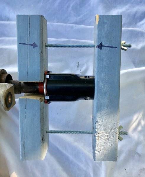

I made a clamp for installing the steering coupler seal retainer. Makes it super easy to center the retainer and hold it place while you fold over the tabs. It also slightly compresses the seal so the retainer stays snug. Tapping with the edge of a small drift and a light hammer you can set the tabs around the raised nubs on the coupler tightly in
place. I’ve never had one come lose.
Scrap 2x3 lumber, two 7” carriage bolts and I centered and glued in a dowel with a piece of fuel line over it to fit in the splined hole going to the steering box just to help hold it and center it all up while installing it on the coupler.
I measure the two sides while I tighten it to keep it even.
Save an old front wheel beraing to add to you harmonic balancer putter onner and install is even easier.
