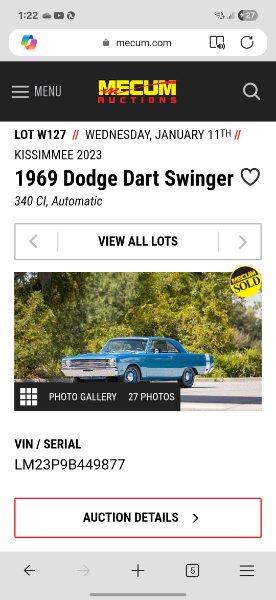

1969 Dodge Dart Swinger For Sale At Auction - Mecum Auctions

you clearly didn't read my other response to you, and that's fine. so i'll repeat it here: never, ever, EVER trust what an auction prints. ever.
you don't know who wrote it, you don't know who gave them the info.
and again, because you didn't read it before: matching numbers to what exactly? the year? to a dart? to a 340? to whatever transmission that's in there now?
Oh I read them. I just am having trouble understanding why you are not comprehending it.

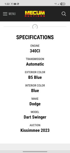

1. The auction states the VIN. Obviously a 1969 Swinger 340.
2. The car has the " MATCHING NUMBERS BLOCK". This does not mean the displacement matches. It says nothing about the transmission. It says nothing about what car it is out of. It is a generally accepted term in the Mopar world starting in 1969 (some 1968s as well) that the VIN stamped into the engine block matches the VIN on both the dash and the body locations.
i don't give a flying frig about the auction. they've been known to be wrong FAR too often.
again, just because it's generally accepted terminology in our world and we have a definition for what that entails doesn't mean that the auction does.
and i don't see why you can't comprehend that.
Are you really basing your argument on the fact that the Mecum listing is wrong? That's pretty weak.
They use various descriptions when describing the installed engine. Some like "a factory P-code 400 or a factory H-code 383" indicates correct style (maybe year) correct displacement Non-numbers matching. Others like "340ci V8" mean just that. All listings that have matching numbers are stated as such.
In our world? This isn't Barney's Sunday Auctions. They sell most of the most valuable and sought after Mopars ever built. As well as every other marque. I think it is generally accepted terminology in their world as well. Hell, even for all other makes! We ain't that speshul

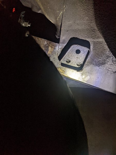

I just cannot conceive any of you could believe a 340 car could come from a manufacture with no right side exhaust hanger .
And worse that during the restoration they forgot it, Welded up the holes and decided it just didn't need one. and do it so perfect under the car its not noticable.
Numbers can be removed and welded into a body with no problem. Hiding that hanger removal would be difficult and for what reason

A missing screw/bracket on a car that has been clearly torn apart since new means it's not a 340 car... OK... The bracket holes may have been filled and it's not hard for a person with marginal body skills to get that done. What could be bad about having holes in the floorboards with exhaust dumped under the car. It's not curing cancer or something.

Could a car have left the factory without an exhaust hanger? I would absolutely bet one could have. Does that mean the car in question did? No idea. But using an exhaust hanger to call a guy a fraud on a 56 year old car that's been restored at least twice? That's more than a stretch, that's just flat out rude. Like I said, facts not in evidence. I'm not saying the car is original, I'm not saying it isn't. But accusing someone of fraud because of a missing exhaust hanger? There's gotta be a hundred legit reasons for a hanger like that not to be original.

No one ever got a picture of the floor pan where the muffler hanger bracket was supposed to be right? So we don't know if the bracket holes are there or not right?

Plus all 340 cars came with a factory right side exhaust hanger. Sure the hanger can be added but when the phillips screw that holds it in place was never there then it was usually added. This car never had the hanger at all and still didn't have one by the sellers own admission. And still the seller is allowed to sell his car as a original 391 car on this site. If we are going to enforce rules that should be one of the most important to enforce. No Fakes sold on this site unless stated as one.
