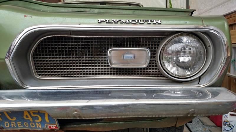

Awesome job on the car. Couple questions about your Grills.
Did you have the outer Chrome Trims Re-Chromed? Who did them and did it cost an arm and a leg?
Mine are driver quality but I want them to be show quality...
I was looking at PG RePops but looks like after reading your thread they are out. Going to try to follow your lead.
What about making the sheet metal fit the new grills? Crazy? Way more work for something that won't look right when done?
I have yet to see any in person...

Hi Randy
Yes I sent the outer trim to a chrome shop near where I live in Ontario (Cambridge Custom Chrome) . They specialize in chroming pot metal as well as show quality chrome. If the frames have any corrosion or pits (which mine did) , they have to be individually filled before chroming - which is VERY costly. It cost me $700 CDN to do both of them!!! My sheet metal fit the grilles pretty good so didn't need much rework.
Jim
Thanks Jim, How much work do you think it would have been to make your sheet metal fir the PG Classics Grills?
Would they be hideous?
I may opt to have mine restored by Totally Auto in PA. I have to travel to PA in December anyway so I might just bring my grills and leave them... At least get a quote before trying to restore them myself. Have to get the Chrome done at least.
I used my original outer chrome trim pieces. I only purchased the inner anodized aluminum trim pieces - and no way would they fit - so that was it for repops from PGC!!
