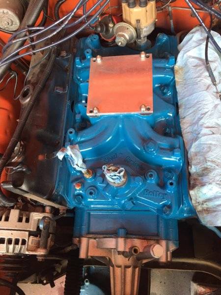

Here’s Chrysler blue with flat black stock valve covers, high temp silver water pump. I like it!
