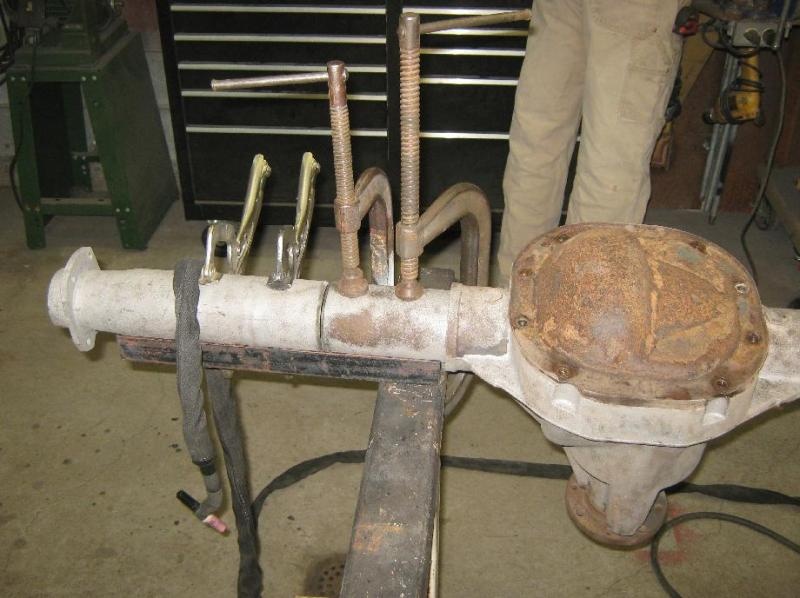

Just cut a slit on the bottom end on both sides, tap it with a BFH, cut down the sides and weld it.
I talked with my buddy, that is what we are going to do. He is OCD, so he will probably not want the bend in there and will make a plate to fit instead for a uniform look.

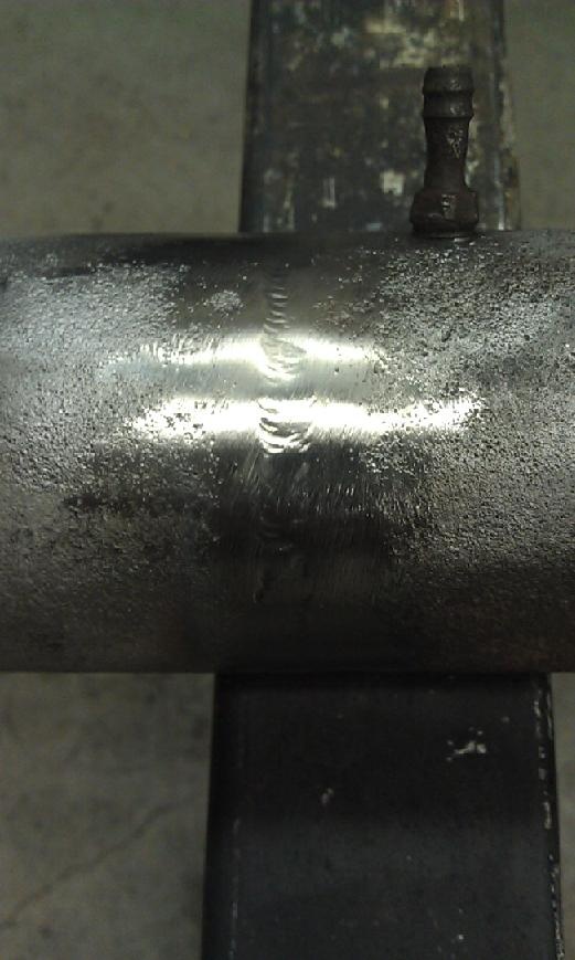

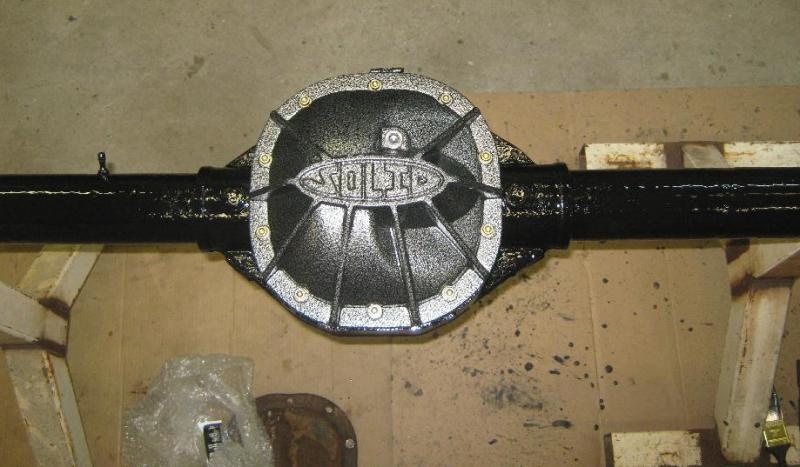

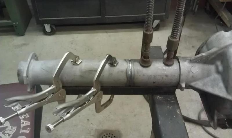

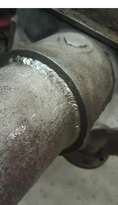

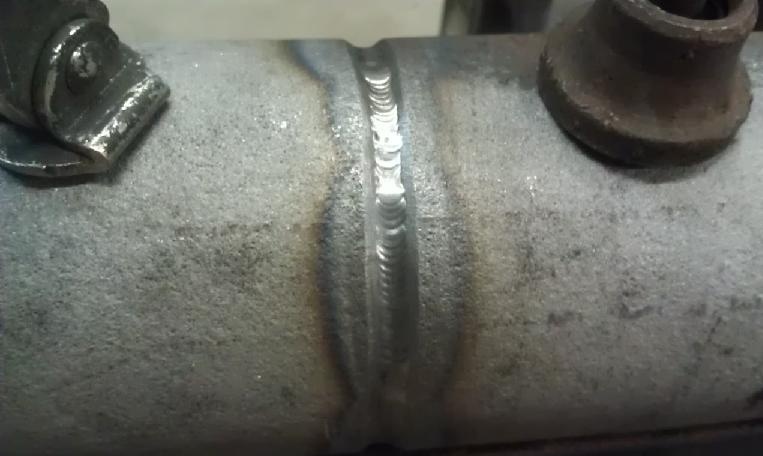

Here are some pics of the rear diff cut and reweld. I did this about a year ago and there are the pics of around because it was in my other Dart. But it is being pulled and put in this one. Everything in this rear is TIG welded:
attachment.php
attachment.php

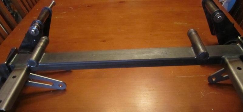

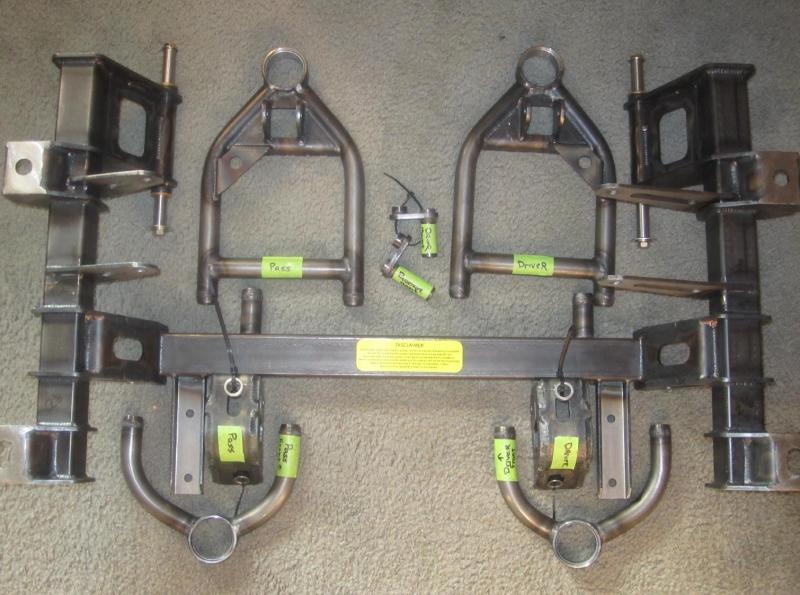

A few more pictures for everyone. This is the HemiDenny K-Frame that is going in the car:
attachment.php

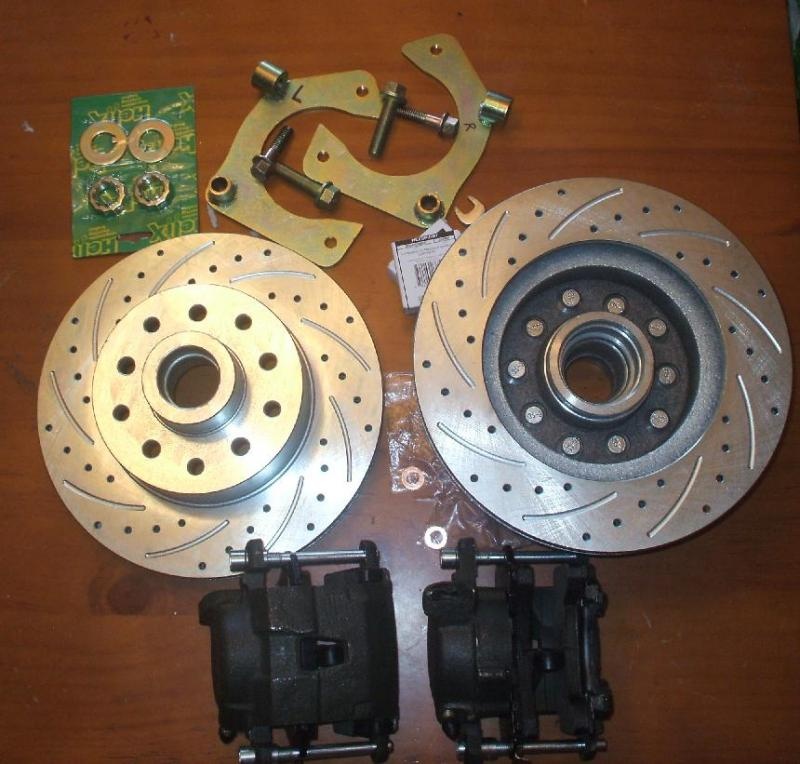

If you go with Denny, you will not be disappointed. I went that route on a budget (as funny as that sounds). I went with the mustang II 2" drop spindles and went a little cheaper on the brakes. I used a kit with 11" drilled/slotted rotors. They are Ford Granada front rotors and GM metric calipers. I will post a pic of them for you.
As for the tires, I had a set of 275/35/20 tires here that I bought for mock up on my minitubbed 72 Dart. I did try to see if it would work. What I found with my 70 Dart with stock wheel tubs/spring location, is that it will not fit without having the springs moved in somewhat and the the fender lip modified some. I have read others that have trimmed the inner fender lip some and offset the springs to get them to fit. I think abodyjoe did this to fit his.
txstang84, here is the brake kit I used. It was $289 shipped. I also have a promo code to get an additional $25 off if you are interested. It comes with 7/16" and 1/2" studs and optional 4 1/2" or 4 3/4" bolt pattern
attachment.php
What is also nice about using the Ford Explorer rear is that it also uses 11" rear disc. So, I ended up with 11" 4 wheel disc brakes.
