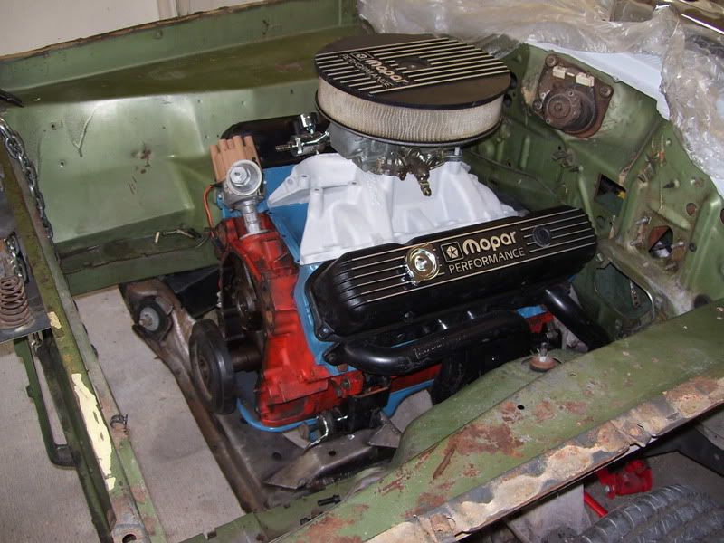

The Passenger header is ready, just a few clearance dimples for the idler arm and a few dimples where it hit the block and trans, but this has nothing to do with A-body, it looks to be a manufacturing inconsistency. The drivers side just tuches the torsion bar, I will have to pound it a little deeper, or cut and reroute the tube, I have to wait to get the steering box so I can figure out if I can cut it or not.

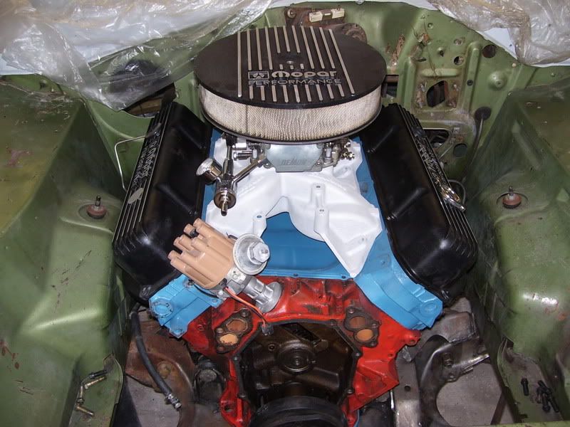

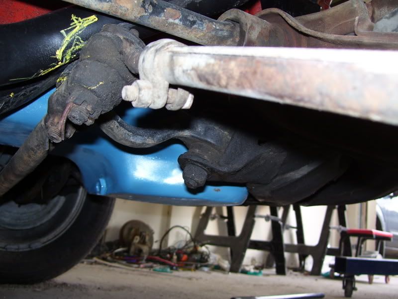

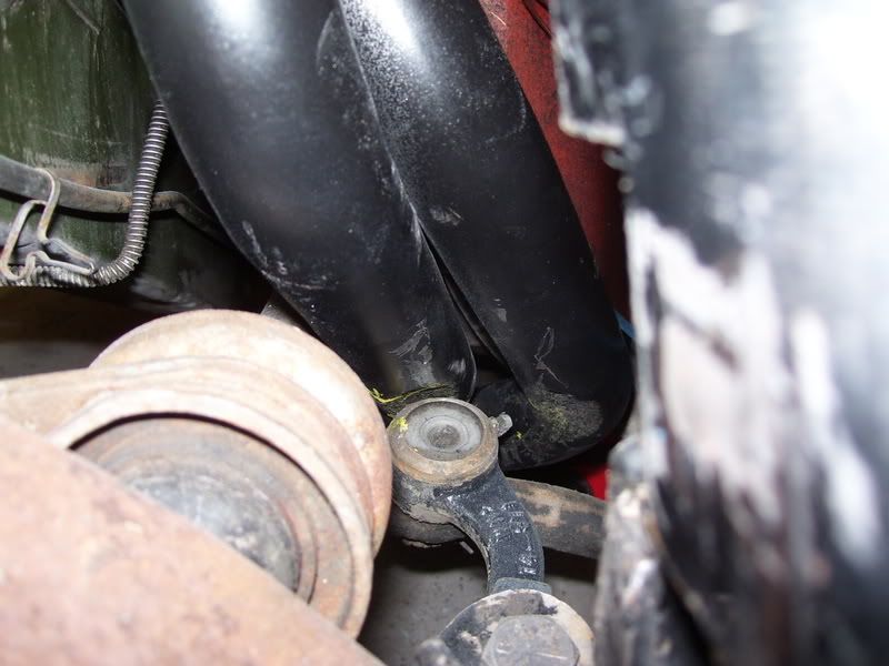

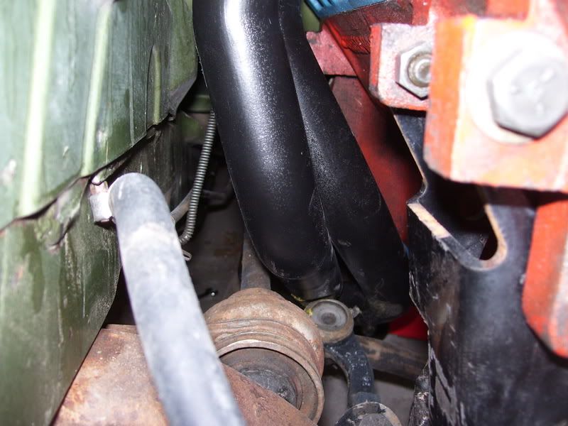

Here is my nemisis. The damn tie rod knuckle. Everything fit pretty well with these headers, but the pass side tie rod knuckle has me pulling the header out numerous times to clearance it. After the last clearancing, the idler arm clears fine, but the tie rod does not, I am going to try and clearance it one more time, but if this dont work and the pipe is too pinched, I am going to cut and reweld that tube.

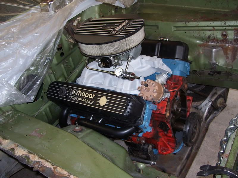

I also fitted the V/C and intake to the engine. Its clear that the air cleaner will not clear the opening in the hood as everything is just too tall, I am going to have to sell it and go with a K&N 11" filter top. I have a hole cut in the hood for the scoop, but this air cleaner is just too wide. The valve covers do clear the power brake booster (good because I wanted to keep the power brakes), and the blower moter for the ac box probably will not fit, but I am going to cover it up anyway, later I am going to add a Hotrod Air A/C and heater unit that will fit entireley under dash. Dont mind the colors of the block and heads, they are just for mock up, my other engine will be 68 Mopar turquoise.
looks good flyboy...i think the chrysler blue and black valve covers look good on that..thats what ill be doing....

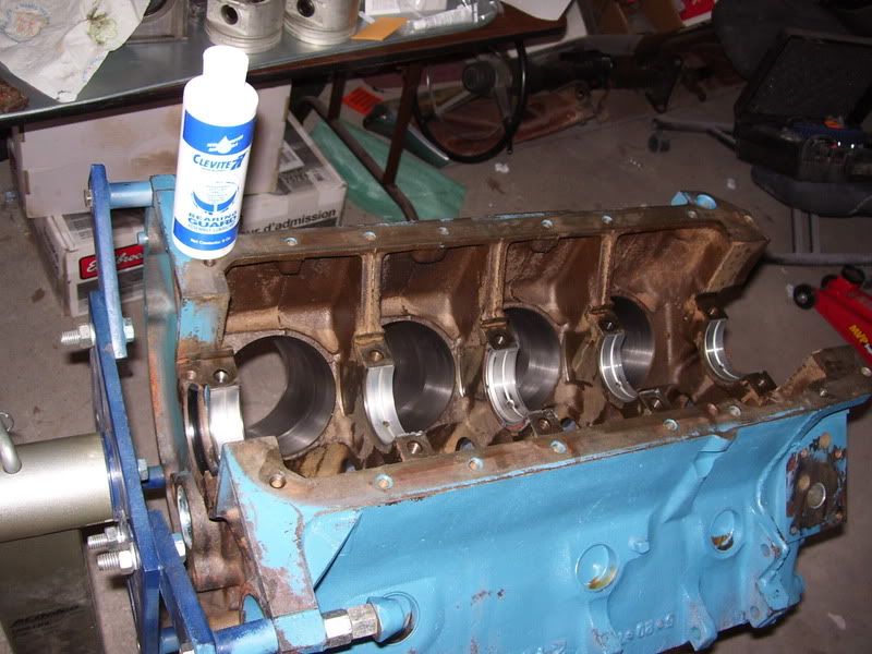

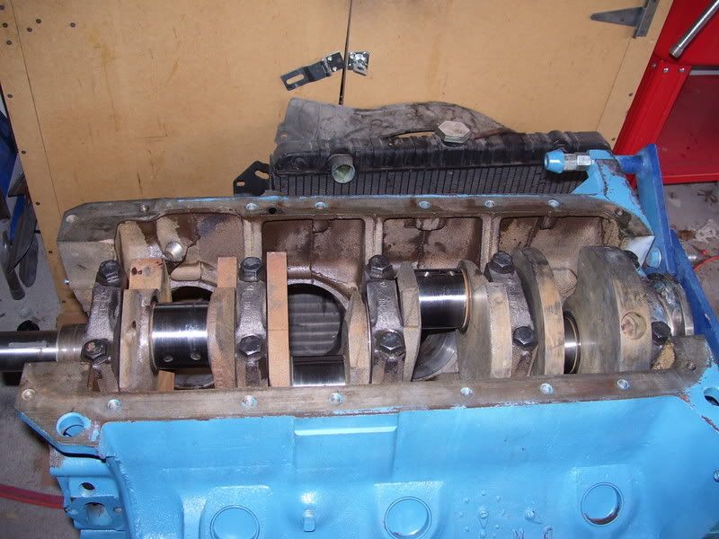

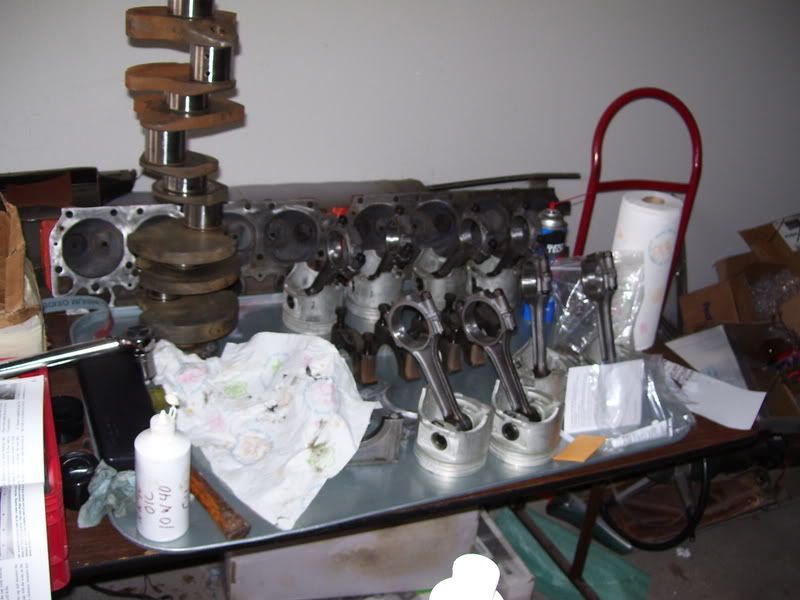

After abandoning my Dart for 6 weeks while I was trying to buy a house, and doing a bit of travelling for work, I decided to work on the Dart today. I started assembling the short block.
As it is:
71 383 block and crank. Bored .030, decks angle milled .041-.044 each side, lifter bores honed, DeTar oil galley mods, 1/2" oil pickup, HV oil pump.
9.73:1 Flat top pistons, .125 valve releifs cut. Speedpro Cromemoly rings, reconditioned rods, ARP rod bolts.
906 heads, new valves, cut for PC seals up to .600 lift, port matched intake ports, Isky ductile adjustable rockers.
Mopar .509 cam, Hydraulic lifters, double roller set, electronic dist, orange box. The engine is set up for more cam, but I am going to give this one a shot, I can always change it later.
Edelbrock RPM intake, Speed Demon 750 carb, 1 3/4 Hedman headers, 9" Dynamic converter.
So, thats my combo so far. here is what i did today:
Today I started assembling the short block. I cleaned the short block, tapped all the bolt holes, installed the main bearings, torqued the caps, checked clearances (.0015), dropped in the crank and installed the rear seal.
Oh, and i almost forgot, if you drop a crank off a table, you can break its fall with your foot! DOH!
Besides crushing my foot, I had a good day, I almost forgot how theraputic it can be.
I remember helping a guy back in grade 12 put one of those together. He half assed so much of it I don't know if it ever got running.
Yup, you need to put it together right if you intend to make it last. In my HS auto class, some guys put together a slant 6 that was so tight, it could not be turned over with a 2 ft breaker bar. They got a fail for their project, it turned out to be a lot of dirt and grit in all the bearings, so much that they were trashed.

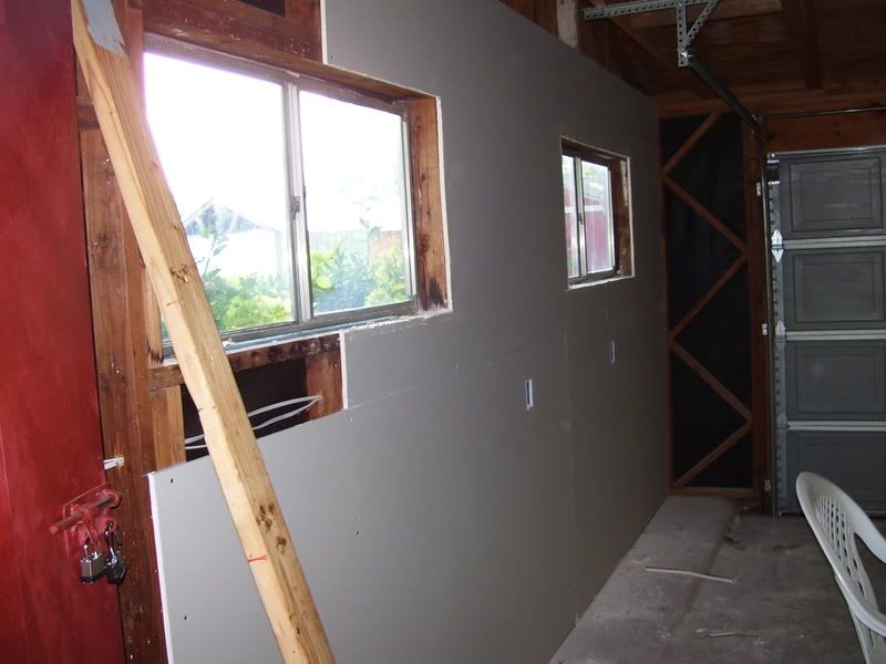

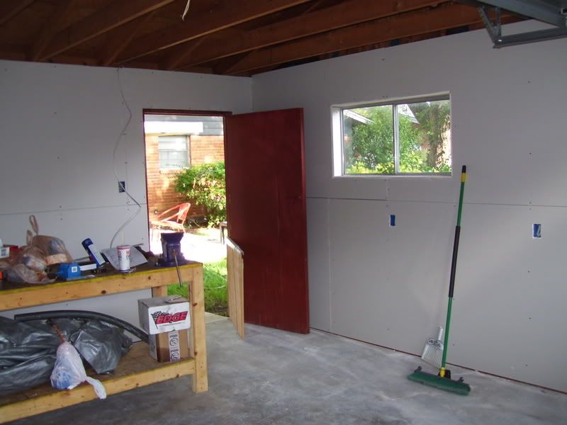

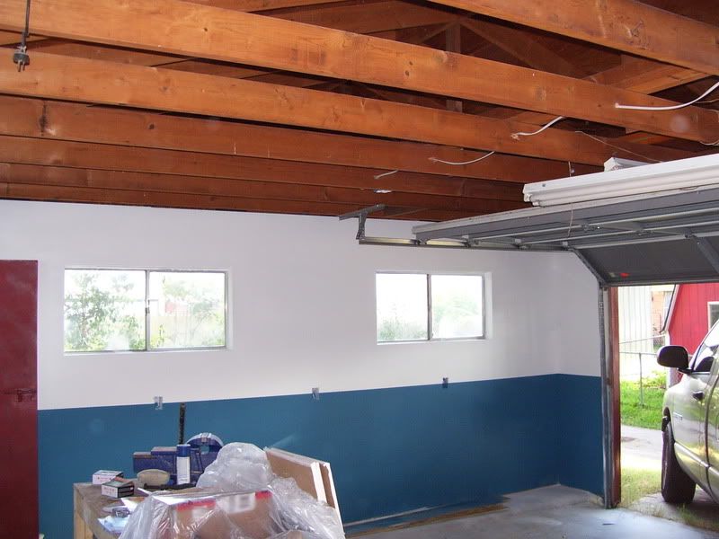

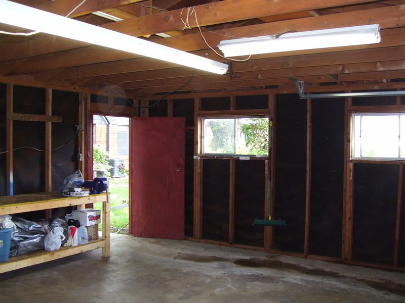

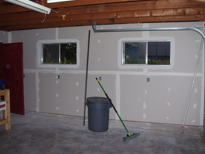

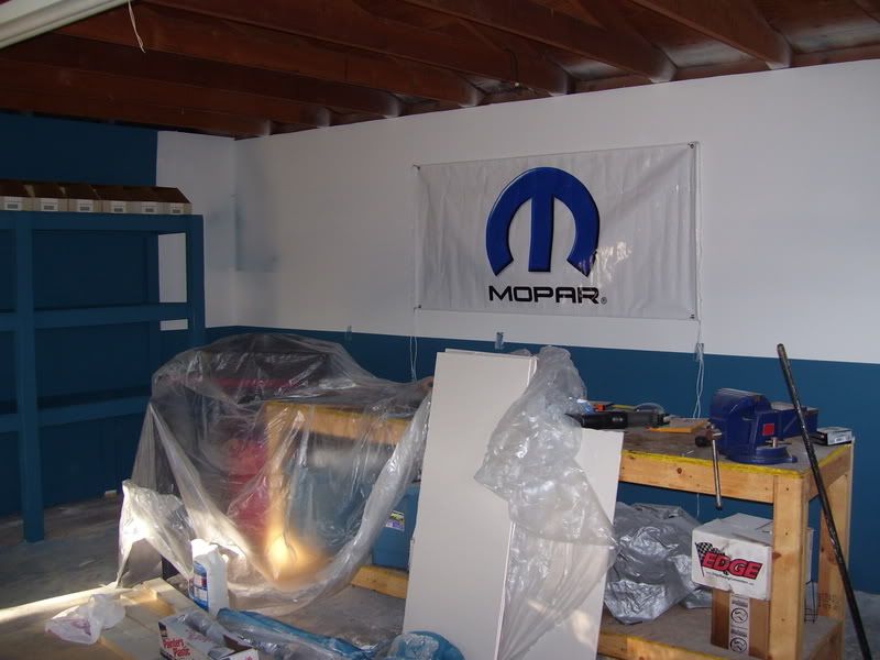

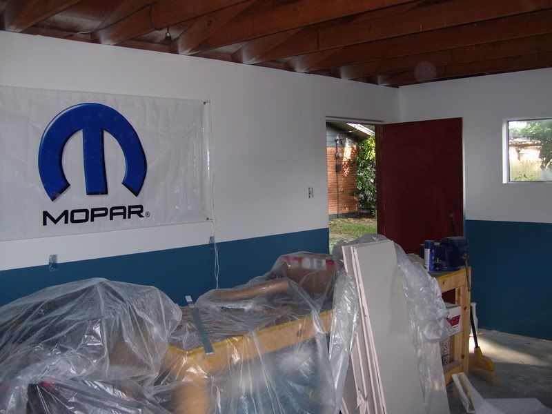

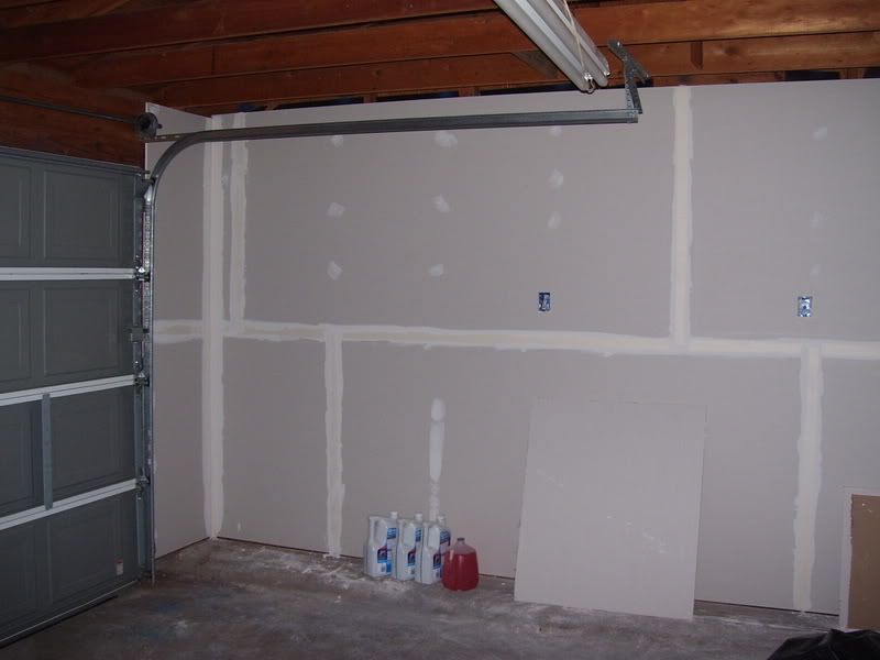

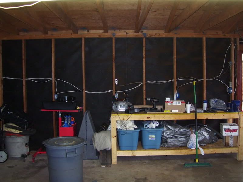

Sorry it has been so long since I last posted, unfortunately the Dart has not been touched since the last post. I bought a house and I have been restoring it for the past month or so, I do however have a cool new garage to work on the car, hopefully I will have paint on the car witha a month or two.
