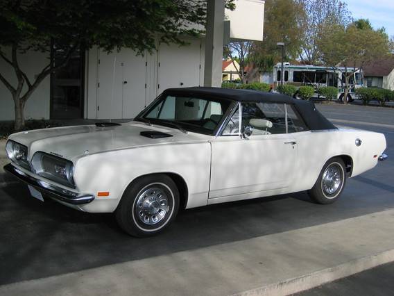

Beautiful story! I got bitten by the convertible bug nearly 2 decades ago. The car has slowly evolved from an anemic Slant six, to a strong Doug Dutra built Slant six, to a junkyard Magnum swap, to a Hughes Engines 408 and now to a supercharged 408.
I find solace in seeing other folks afflicted with the same bug. Vive la difference!!

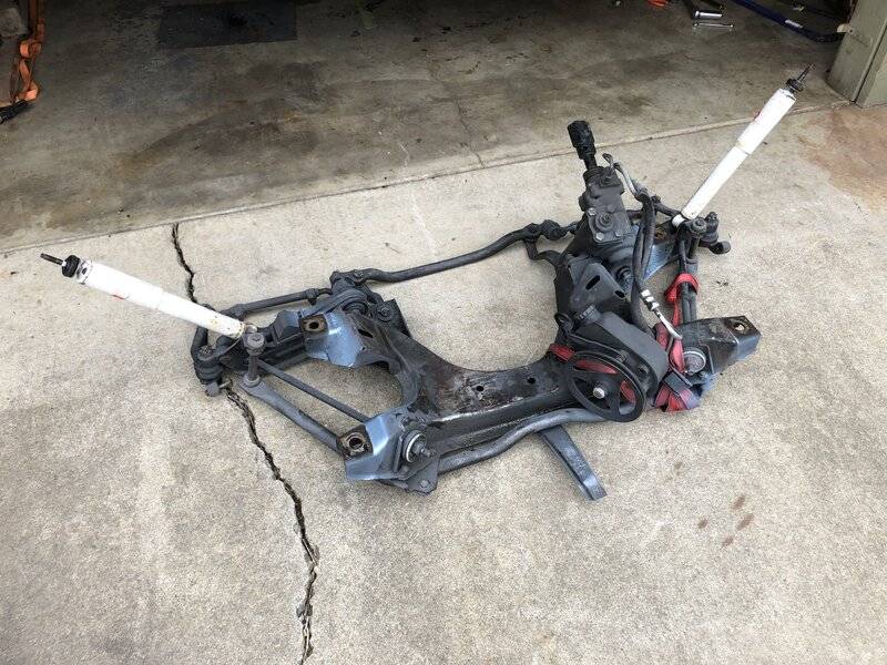

With the paint done I needed to pull the k-member and start detailing under the hood. All the rubber is in great shape and will be reused. If I can it will remain together and go back in that way. I have a proper 68 v8 k-member that will be used.

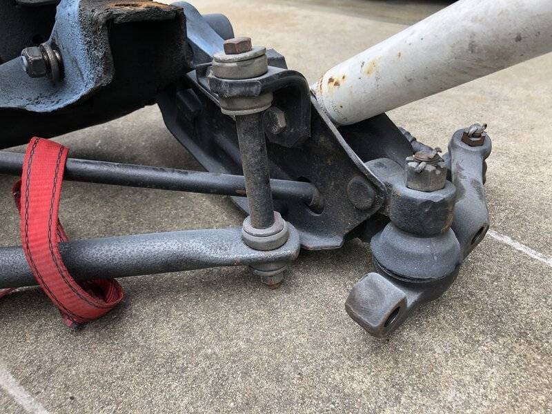

Sway bar reference pictures
An attempt to correct the poor geometry from the sway bar company.
Will get a coat of black paint before it goes back in.

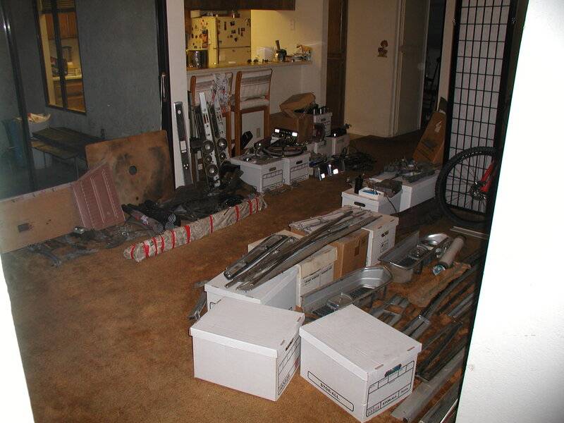

The house has been an ongoing project and multiple cars were done at the same time.
In 2005 I set out to restore my Barracuda Fastback, at that time I collected everything and brought it inside.

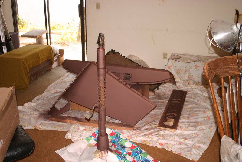

While working on the Barracuda now 2008, the car was painted and I needed an area to paint parts...
The living room today

We welded the aftermarket sway bar frame brackets to the K-member in my son's fastback. They are too flimsy otherwise, especially with the BIG bar.

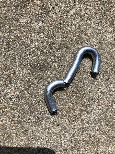

The only issue started when I couldn't find my chain lift sling as I use a carb plate on the v-8s. So I ran down to the parts store and purchased another one, back in business.
We get the hoist hooked up and start the lift (with the transmission attached), we were at the point where we were going to start to move forward to get some more clearance and the engine drops back in.
At first we thought we broke the stud at the rear of the engine we were hooked up to but in looking at the sling we noticed the links on the end holding the brackets were not welded and it just opened up till it broke.

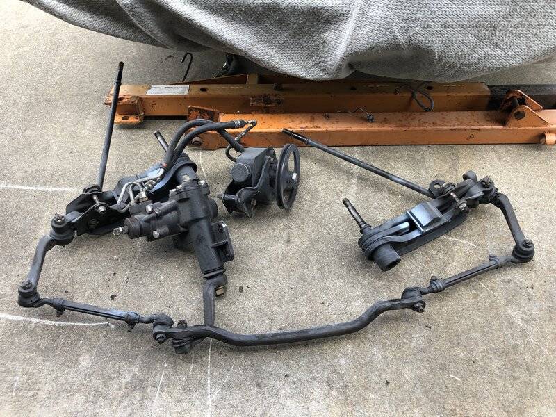

Max had upgraded the power steering to a Borgeson gear and Saginaw pump. I had to get a different bracket kit and make some adjustments to the hoses. Still not sure I can get it in the car like this.
