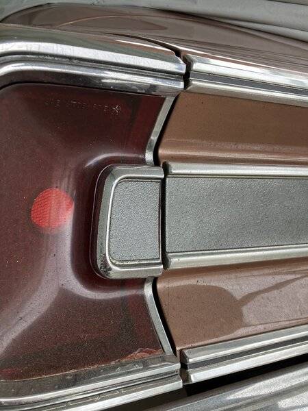

After tackling the grills I'm tempted to do the original trunk trim as well instead of the repop. Is this repop Al?
Hard to say, the edges look a little soft.

The easiest way to tell is to show it lined up with the taillight bezel. Originals are different top and bottom because the slope and surface width of the bezel is different at the top and the bottom. Each piece of trim has a top slope and a bottom slope, and a top surface width and a bottom surface width, divided by the black stripe. All 4 of these features should line up with the bezel. Closing the trunk lid would give you a better idea. One thing, they should be clearly different from each other. The repros are exactly the same top and bottom, which is the problem.
I just noticed my trunk lid isn't closing properly on the right side... better look at the left side. The widths of the surface flats should roughly match, the angle of the surface should match, and the angles of the return bevels should match. The widths aren't a precise fit, but the angles should be right on.

Hard to tell, thanks guys. I'll have to pull out original set to compare.

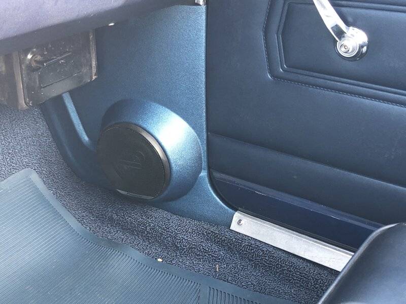

When I first got the car it had speakers in otherwise perfect door panels.
New door panels were installed and the speakers moved to the kick panels.

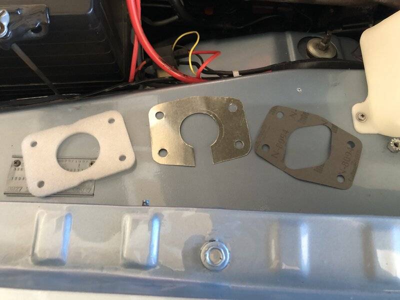

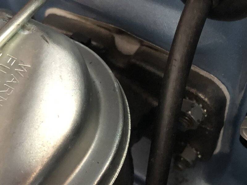

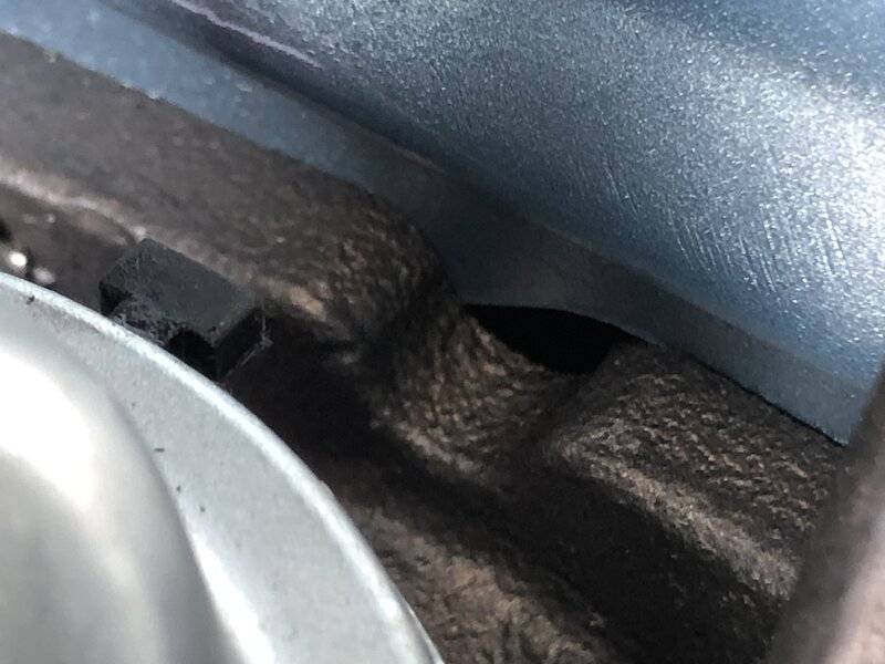

When I put the new master cylinder in I noticed that the housing didn't cover the hole in the firewall.
Not wanting water or anything else getting in I chose to cover it up.
Without pulling the master I put the fiber gasket in first (cut bottom open).
Placed a sheet metal piece in.
Then the foam.
Finally the master
Alan

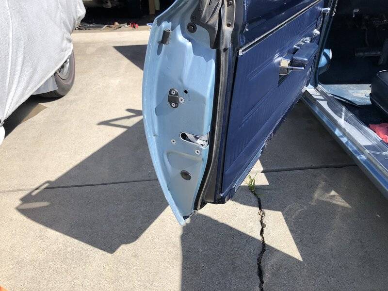

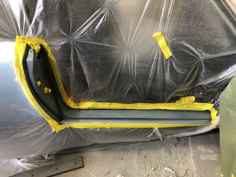

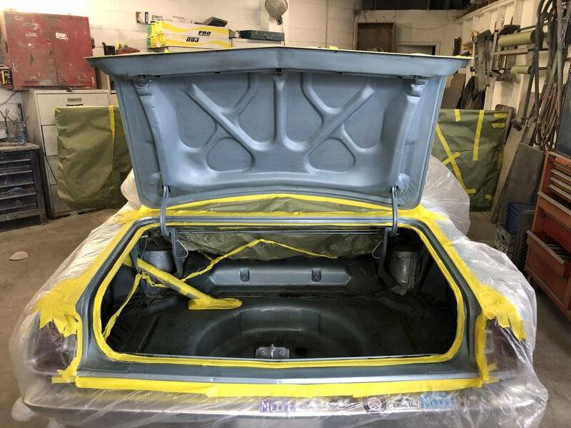

With the car starting to look real nice I felt a few areas needed improvement. First the door jams were overlooked on the previous repaint and had flaking paint. While I was at it I had him shoot the inside of the trunk.

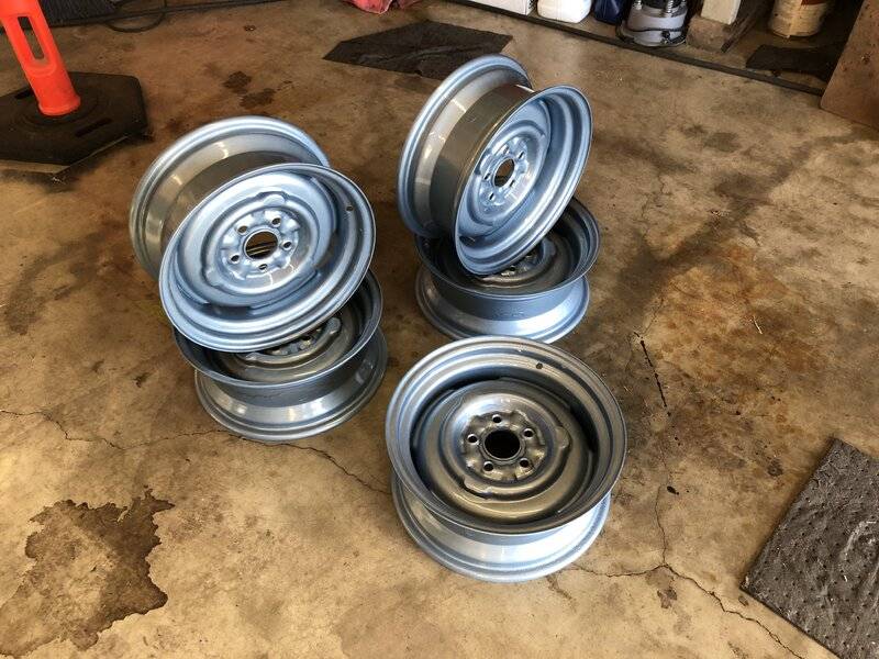

While the car was at the shop I had him paint a set of wheels to match the car.

With the inside of the trunk painted I cleaned up the jack, put in a new mat.
The latch and catch were cleaned up in the process, along with all the bumper hardware.

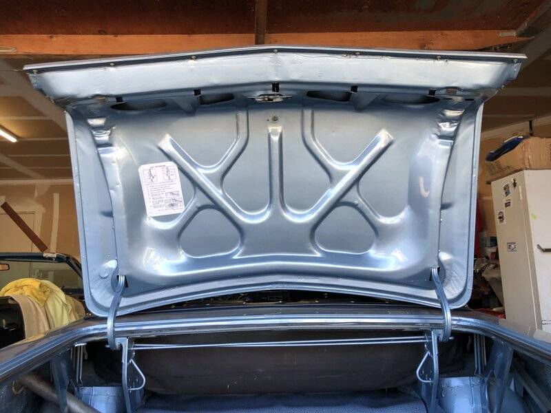

The new ECS trunk decal was put in towards the left. Interesting note: this is a late 67 (May) car and it has the solid inside trunk panel without the punched out sections.

With the door jams painted most of the hardware had been painted over at one time or another. I removed some of them one at a time alternately so I could refinish them and not have the components fall into the door. The latch was painted in place, not restoration perfect but better than being painted blue.
