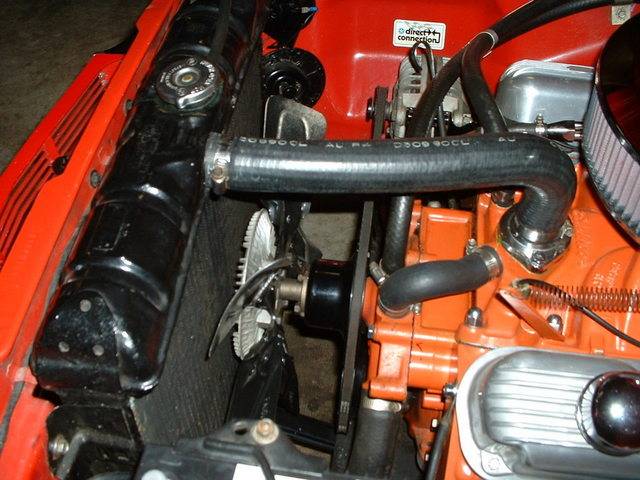

I have a 64 Polara with a big block and a clutch fan. Been so long since I put it in I don't remember where I got it. Pretty sure it's some kind of Mopar clutch, though.
I did have to melt the solder holding the brackets to the radiator and move the radiator forward, then re-solder. But I think that was because the radiator shop that put a new core in didn't put the brackets back in quite the right spot.

I have a clutch fan in my 65 Barracuda with the factory cast iron water pump.
For a while, I ran a Duster 340 radiator and the later aluminum water pump. Clutch fan wouldn't fit that setup.

My combo:
68 Barracuda, 360 on a 70 Duster340 biscuit mount K, with a Milodon late style Hi-Flo pump, and a rad/shroud/fan/and over-flow tank all pirated off a 73 Swinger 318 A/C auto car. The pulley I just grabbed out of a box of 'em that I had kicking around. Got no idea what it's off except to say that it is bigger than the crank pulley, which is smaller than normal, in an effort to not thro a belt at 7200. So far so good, going on 23 years.
