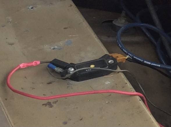

Use a GM ECM and new regulator regulator regulator View attachment 1715786307
I did exactly that on a Ford I was having troubles with the amplifier box, that big POS on the inner fender. I figured out a GM module could be wired to work. Went to a self serve wrecker and took one out. No more problem. Eventually I could not get it to start as the ring gear teeth were chewed in one area. Crankshaft had almost 1/8" end play and the bearings were copper all around. This was a California EEC 2 car in Canada with it turns out 300,000 miles. I think the crankshaft jumping around was confusing the crank position sensor and the module.

Almost all new ECM's are just a GM HEI type system inside and that big 'Transistor on it is FAKE. It is so easy to mount and wire up a HEI module and it will trigger off a Mopar factory Electronic Dizzy. Run a good E coil and have 65K+ volts at the plug. These MUST be grounded. Some HEI modules may have a bit of timing pull out as the RPM's go up, so do some research.
