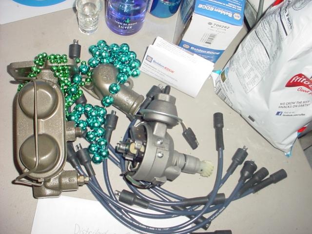

My plan for the evening to watch some drag racing and get my J.D. 00000.1 distributor came to a flying halt yesterday :eek:ops: I should have wore different shoes before I went out
to the nest, or I pulled something moving Buddy's kennel :banghead:
I got as fare as removing the old dizzy and wires, marked the old dizzy and stood up :eek:ops:
Another day I quess ](*,)
