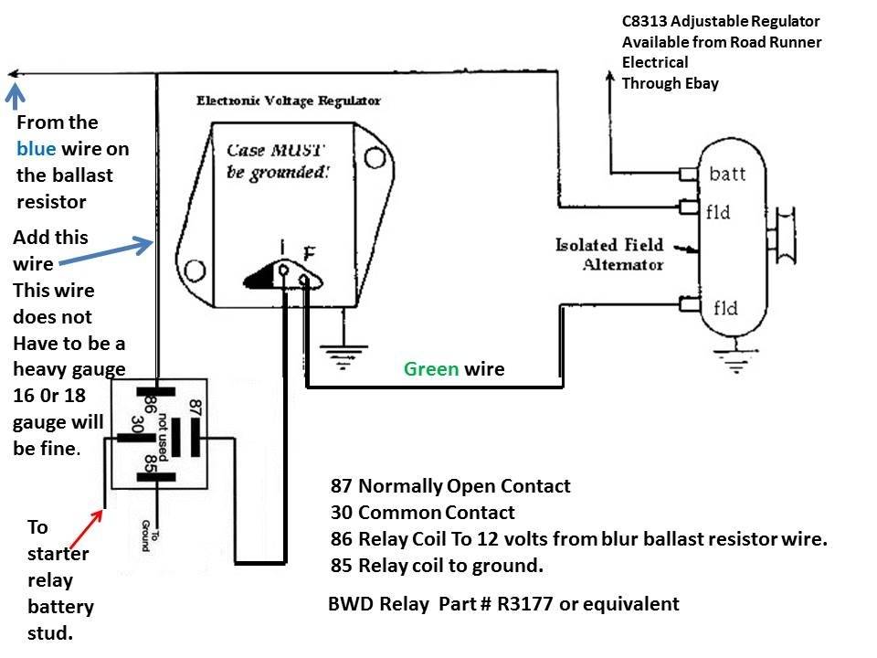

[I had an issue not too long ago with my voltage g around 15 volts, my headlights were flickering and my voltage gauge was jumping. I fixed it with an adjustable regulator and a relay. Here is a link to the thread and the wiring diagram I made. Hope that this helps.
ATTACH=full]1714962996[/ATTACH]

its funny I actually commented on that post back in june to see what had happened with the OP's issue and forgot to "watch" that post. thanks a ton for bringing that to my attention
No problem, that worked well for me and that adjustable regulator was only about $20.00. I paid $35.00 for a nonadjustable one from Napa. Let me know if you have any questions. Good Luck
